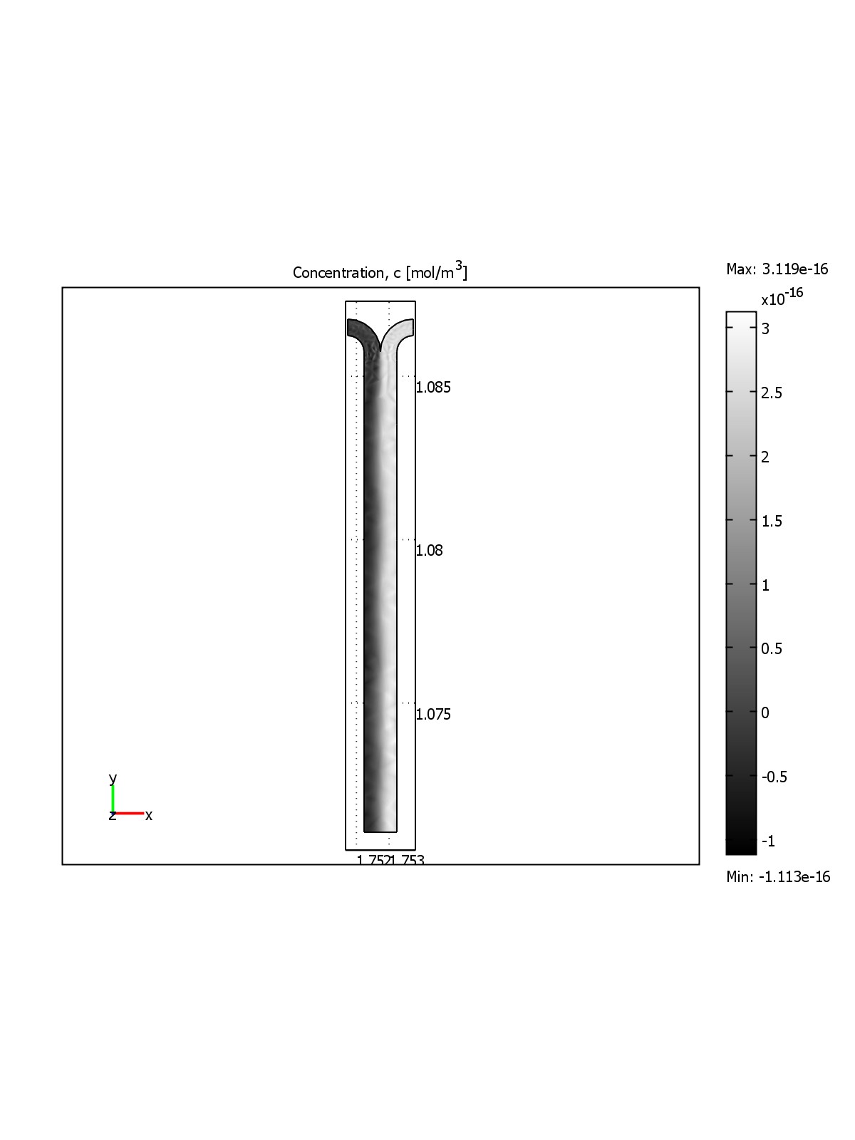

Thanks Ivar, it seemed to work. I'm now using "0 pressure" output, and velocity driven inputs.
However, the simulation reveal some odd results, e.g. negative values on concentrations, but also concentrations larger than the boundary conditioned concentration. This can be seen in the attached picture, strange artifacts can be seen at the inlet.
Is this a result of the "0 pressureoutput/velocity driven input"-method, and will it be solved by your recommendations of fixing the gauge pressure and then solve again, now with pressure driven input?

indeed the negative concentration is a recurrent issue taken up on the forum, that is really something you should take up with "support". I suspect that some "log(C)" of the concentration approach and adapting the Physics accordingly could be a way out to handle the large "numerical, positive only, dynamic" of chemistry induced physics. But I also understand from others on the forum here that it is not that trivial ;)
You could also use the driven velocity input/output, and then only fix the pressure on one point at the outlet with a Point pressure node. remains the issue "0" gauge pressure or 1 atm or ...
As you have also concentration I'm always uncomfortable with the physics coupling: for me "0" pressure means also "0" concentration (if the formulas are 100% linked, but I believe its not the case.) Anyhow Chemistry physics is not the one I use most, so I have had no time to test it correctly and to make up my mind
