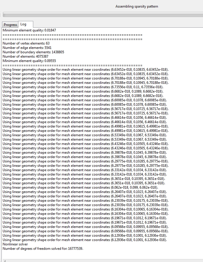

I am stuck at 15% in the "Assembling sparsity pattern" process. 93% of my physical memory is taken by COMSOL (all 24GB of it!!!!) but 0% of my CPU is being used....which is rather weird to me. Is COMSOL doing anything at all or is "subtly" crashed?
If the CPU is not being used then surely the simulation is not running right? Or am I missing something?
Should I wait or should I stop it?

Thanks for the input. I guess you are right since my 3D model has 4,000,000 elements.
(see Log in attachment)
I'll launch it and go for the week-end! :)
It would have been nice though to have some signals showing that the process is working and not just stuck (it was stuck at 15% for at least 1 hour).

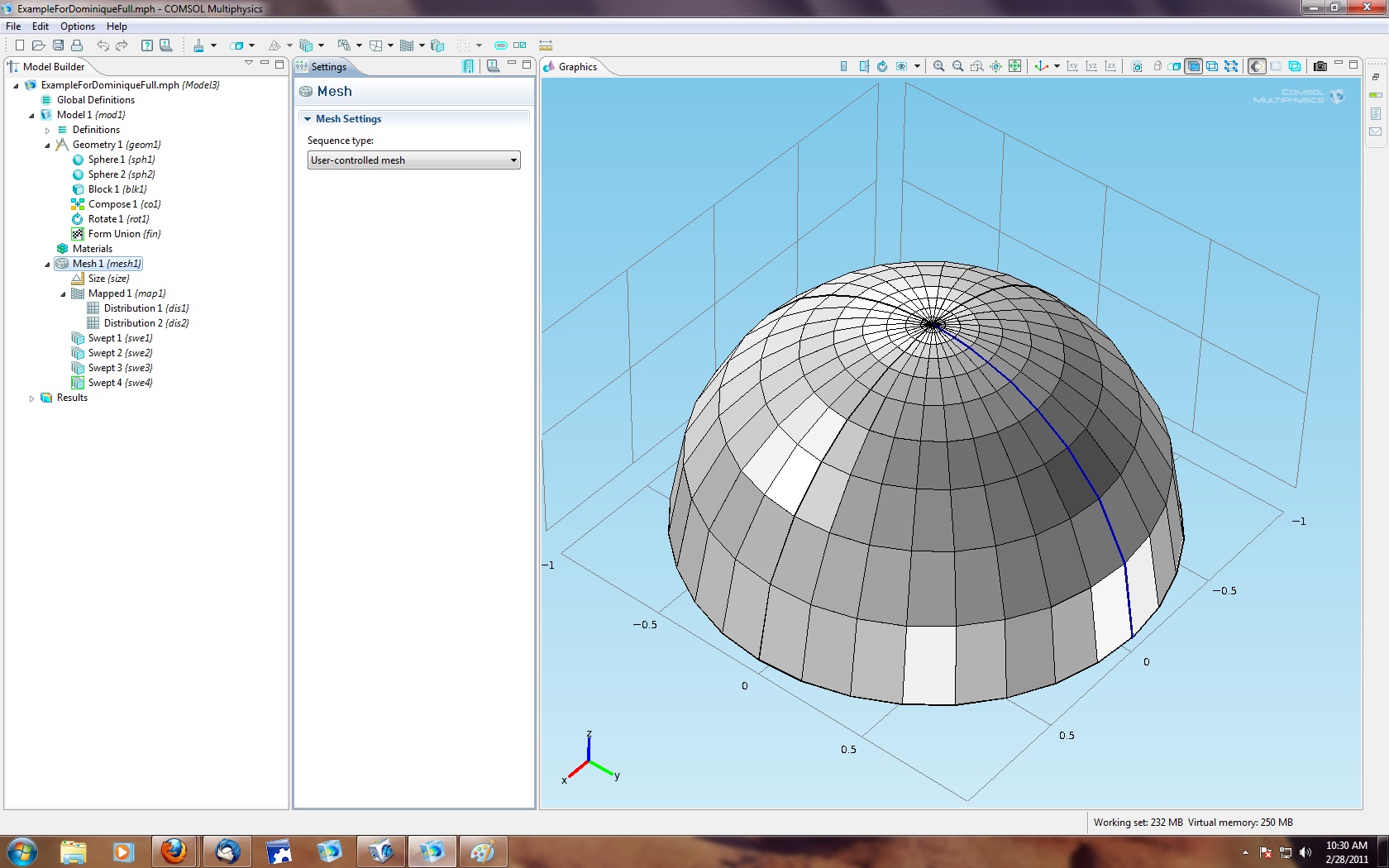

I am not sure how you mesh that hollow half sphere, but I can't see how you would not be able to reduce the number of elements much further. In the attached screenshot, a quarter of one ply of your structure is meshed with 750 elements (and you could use a coarser mesh in the theta direction), while using 5 elements through the thickness of the ply, which should be plenty. That's 3,000 elements per ply for the entire structure. I can't imagine that you have 300+ plies.
What am I missing?

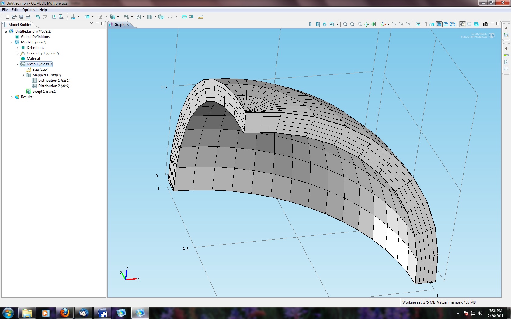

The same meshing approach carries over to your hollow half sphere. This is done in the attached file. Notice that I built the geometry by patching together four quarters of the geometry. This introduces internal boundaries that are used for meshing.

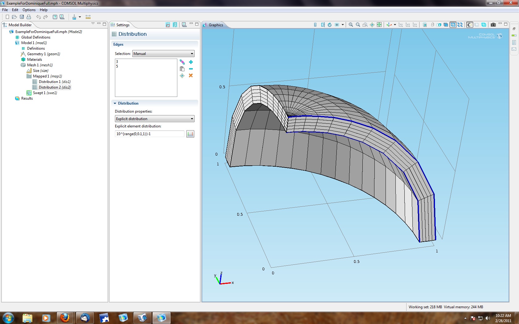

Regarding your second question: you can use the Distribution nodes to control the distribution of your mesh; this gives you complete freedom over your mesh distribution. The attached screenshots show this.
