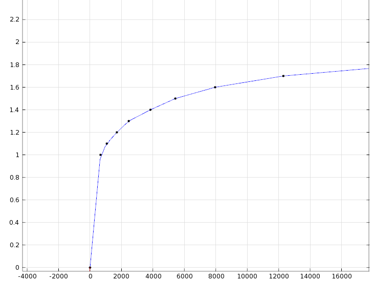

I actually do have a question about the saturation. Because the embedded material property for iron has the BH curve that doesn't saturate till B reaches around 1T. Since the peak value in the middle of the solenoid is only 0.6T, does it not mean the core material for both cases have not saturated yet? Thanks.

I agree that it did not look like it was saturating, but again I looked rather quickly ;)
Nrmally 0.6 T in the midle should not imly much higher for the rest of the module (in steady state)

Thank you! So that means saturation doesn't happen in the whole model, right?
