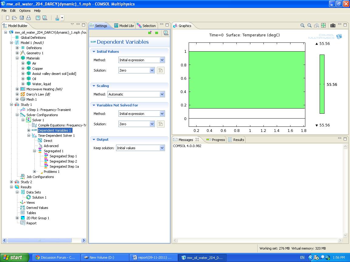

Please have a look on the attached image and let me know in which section of the solver I can define use of only specified results?
Many Thanks in advance!
You should search for a "output" tab in the Time-Depedent Solver node (or a Parametric sub node if you do a sweep). There you can specify the times to store ... (or steps given ...)
