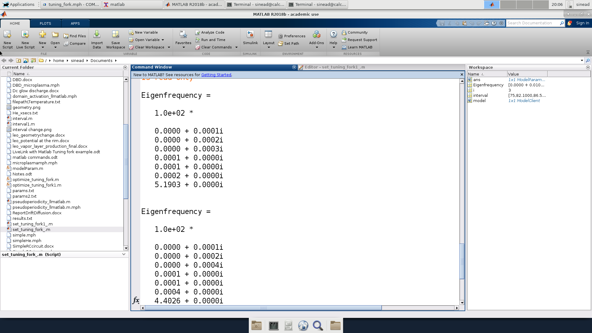

I was wondering could someone tell me why my eigenfrequecy output is like the attached screen capture and not a single value like it it in the comsol model when I specify 1 value not 7.
7 values are outputted and I need to multiply by 100!
my matlab program is
model = mphopen('tuning_fork');
interval = [75 82.1 86.5];
for i = 1:3
model.param.set('Lp',interval(i));
model.study('std1').run;
Eigenfrequency= mphglobal(model,'freq')
end
Any help would be greatly appreciated...
