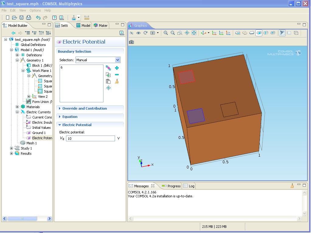

Thank you very much for the detailed response!
Could you elaborate a little more on the "port scan?" I tried to search in my COMSOL documentation and online, but the closest function I found was "port sweep" in the EM Waves Interface, about which I am not sure how to perform the tasks I desire...

hi I could not get the parametric sweep to do what I wanted, but the save as M-model really simplifies the process, thanks a lot.
however, does it ever happen to you that you get different solution result running in matlab than running in comsol?
i first ran one case in comsol, export the data. then saved the exact same file to a .m, and in matlab console ran it again. i literarily got somewhat similar but different data set...
if it were minor differences i would not even bother, but than it occurs when in comsol it gave me the solution very quickly, in matlab it complains about "divergence of linear iterations."
