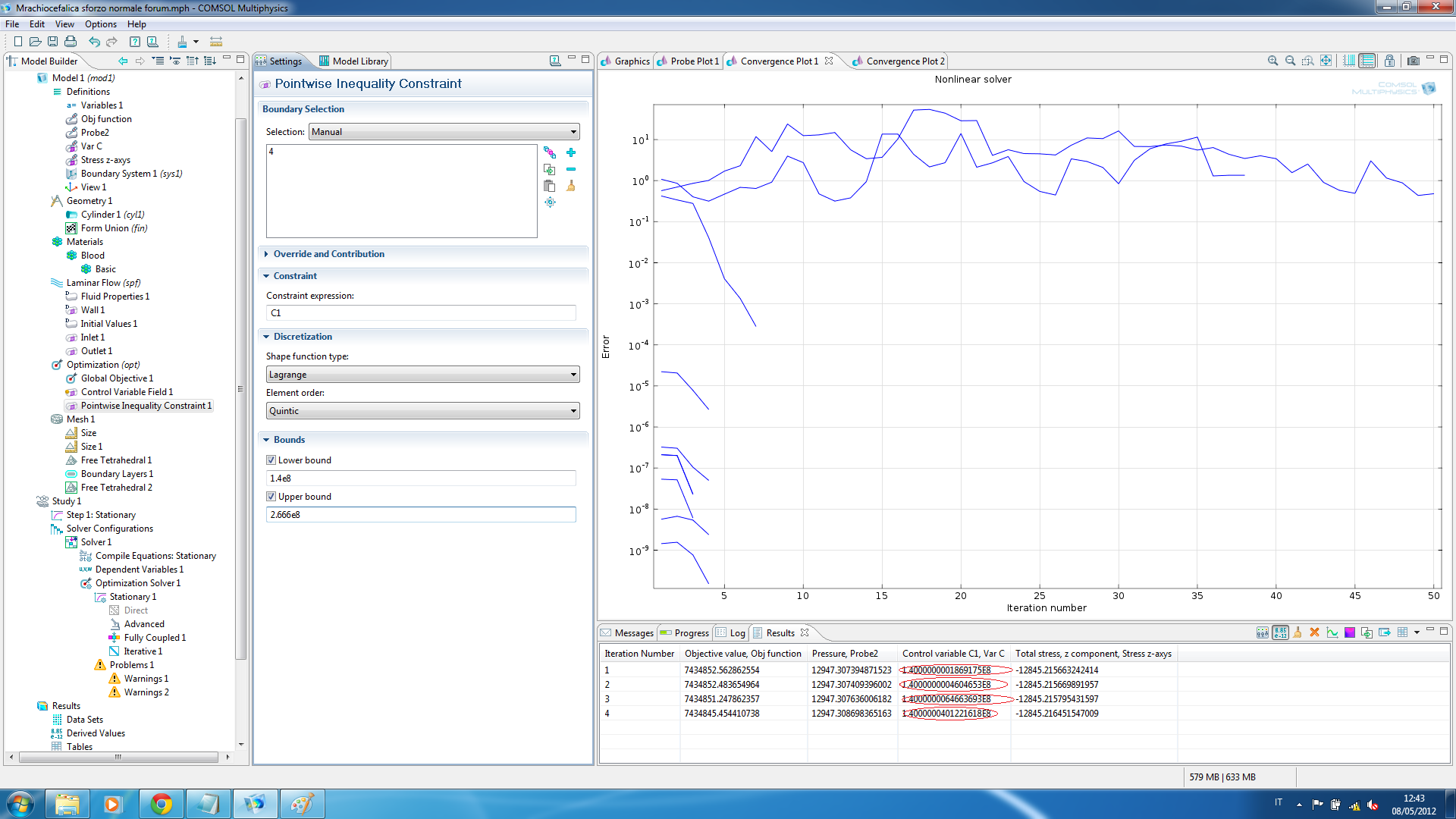

Thank you very much for your answer, i found it very useful. I forgot to specify that my model is 3D and p is the average pressure over the domain (my model is a simple cilinder, so there is only one domain); so i setted up a probe to calculate the average of p over the domain (named by comsol "dom2") and setted optimization module this way:
Global Objective: (dom2-15000)^2
Control variable Field : C with an initial value of 1.4e8 (opplied only to outlet boundary)
Pointwise inequality constraint: C with lower bound=1.4e8 and higher bound=2.666e8
I used that values for C because i found on a paper that they should vary from 1.4e8 to 2.666e8, so the optimal value should be between these.
However i think that i should change some setting to consider the hugeness of C values:
infact, as you can see from the attached image, the variations in C value each iteration is too low, so COMSOL returns only a few of results and then stops saying that the current point can't be improved.

The ill-conditioned preconditioner warning suggests that your model is not well formulated. As Ivar suggested, try running a parametric sweep on several values of C across your inequality range to make sure the model solves properly. This will need to be fixed first.
Other comments:
I see you have variables C1 as well as C. What is the purpose of C1? You should optimize C directly if C is the parameter in your equation. This may contribute to the lack of progression in your optimization.
I see you have defined a Control Variable Field for C. This should be a Global Control Variable defined as C.
You have defined a pointwise inequality constraint on C1. This perhaps should be a global inequality constraint (again, on C rather than C1). With C defined as a Global Control Variable however, you can provide the upper and lower bounds in that dialog box, eliminating the need for this additional constraint.
Your model is stuck with a pressure of 12947, which is a distance away from your target of 15000. Using the parametric solver, make sure there is not a local minimum near that value of C. Given the form of your equation, I suspect this is not the problem, and reformulation of your model as described above may take care of this.
