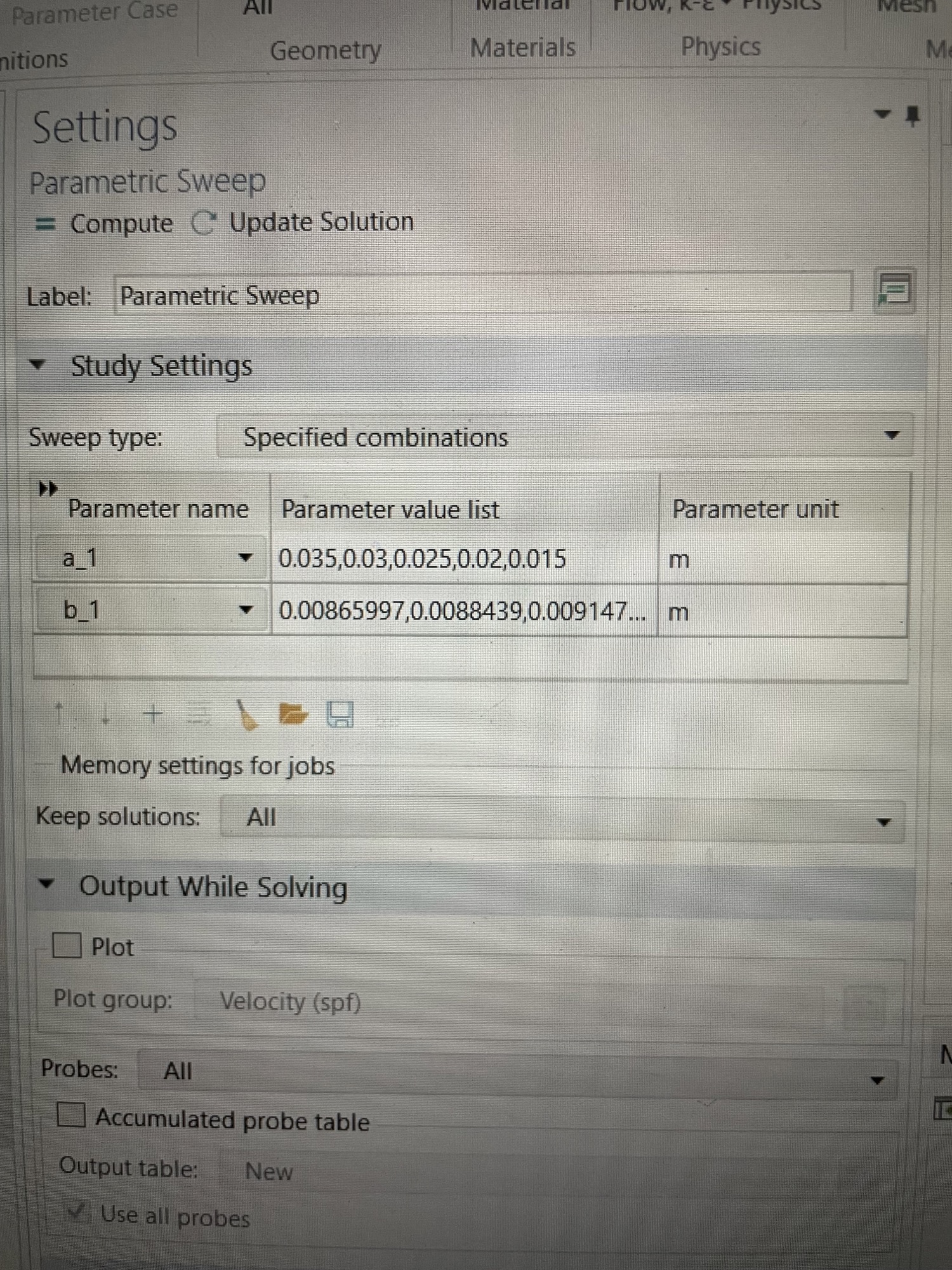

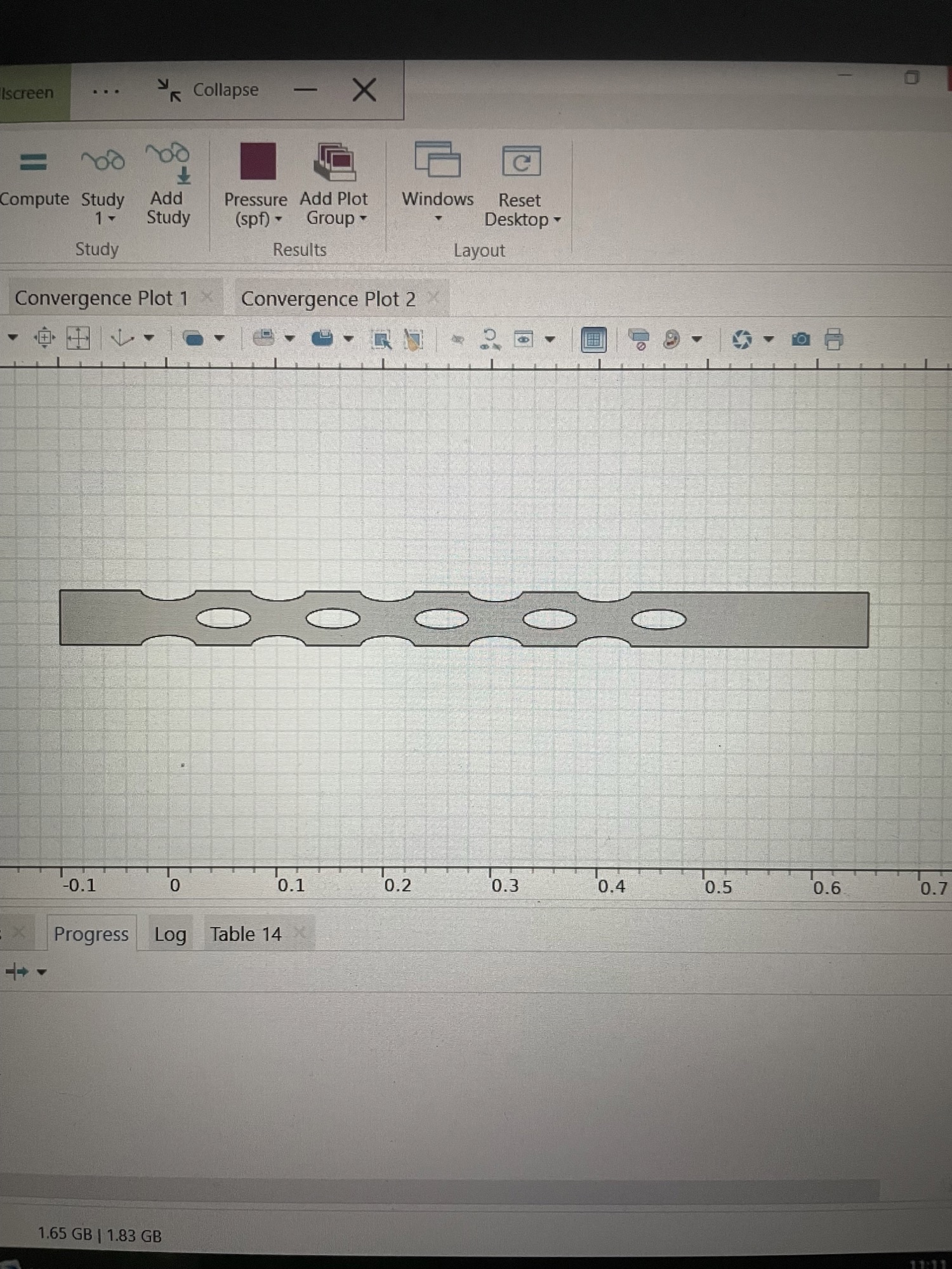

I am doing a project for school where we have to optimize a bank of tubes to have the least amount of pressure drop over the system. The hydrolic diameter of each elipse needs to stay constant so when the height changes the width need to change. The equation to relate a and b is to long to put into the computer so i was wondering if i can input both a and b into a parametric sweep and if each can change for each sweep without relating them to each other but instead just inputting the values i want for both a and b for each sweep.

Jacob,
this is possible. Check the documentation for parametric sweeps.
Cheers Edgar
