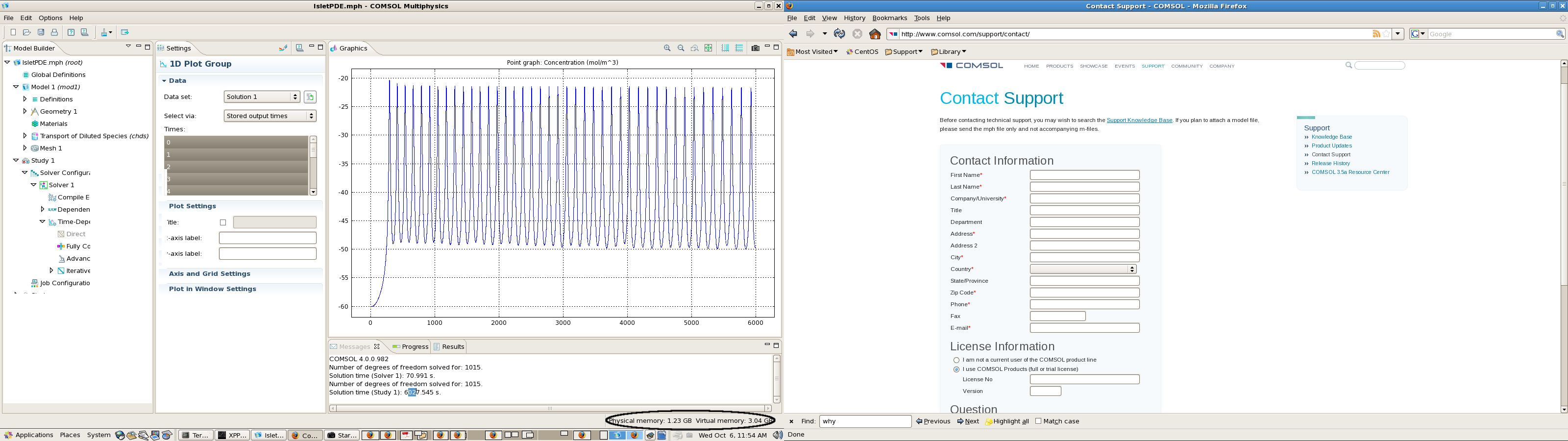

Dear All:
I have plenty of RAM on this machine (16GB) and I am running 64-bit Linux. Oddly, however, Comsol is indicating that it is using almost three times virtual memory as physical memory (screenshot attached). Shouldn't Comsol be using RAM first, rather than so much of virtual memory/swapping?
Could anyone explain to me what might be going on here? I am wondering if there isn't a way to force Comsol to use more of the RAM instead of virtual memory and hopefully get some speedup.
Thanks much,
Pranay

It's true that I do have to run a transient problem with a lot of time steps. But the issue of large Virtual Memory seems to be independent of the problem I need to solve: even if I simply start up Comsol - no model, no solver, nothing at all - the Physical memory reported is 288 MB and the VM reported is 2783MB. 10 times as much! (On my Windows laptop, which has a total of 4GB, both values are lower, just over half a GB in fact.) The command I'm using here is just:
