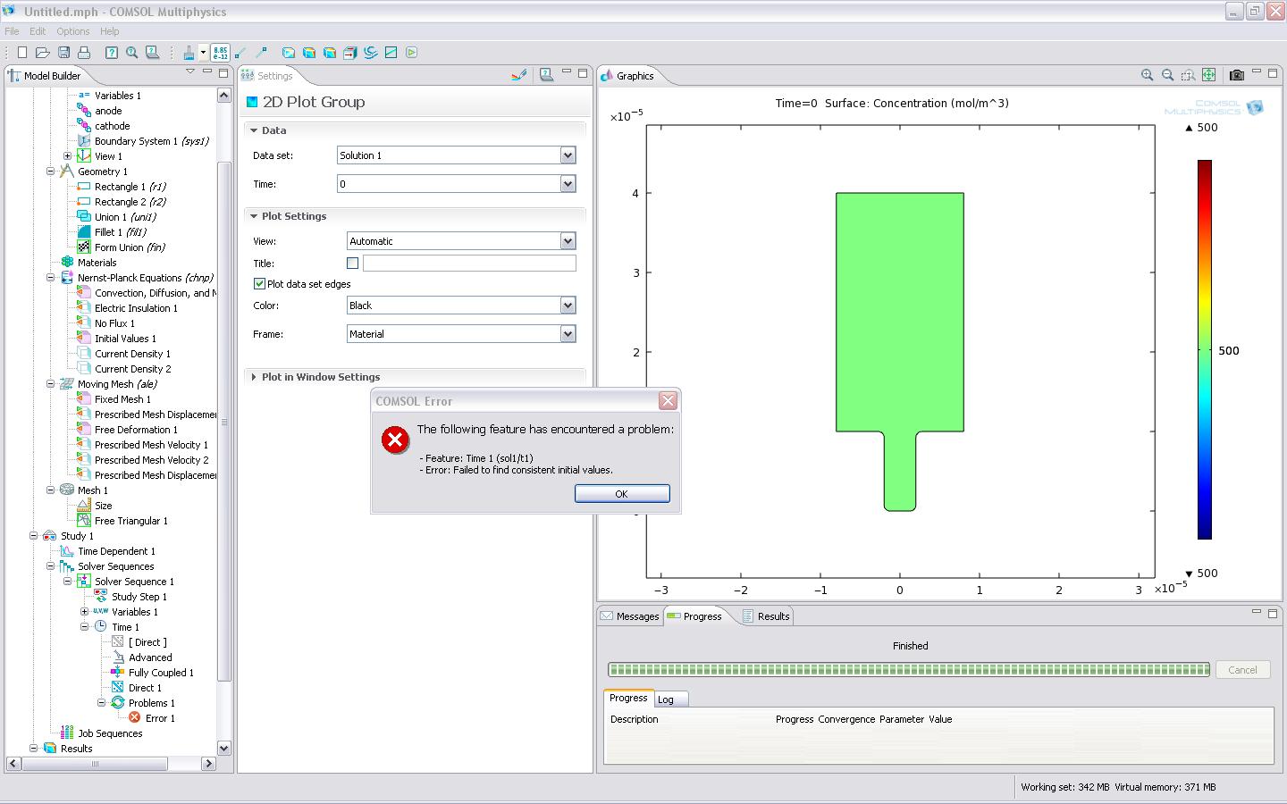

Failed to find consistent initial values in Copper Deposition model
I just started to use comsol for simulation an electroplating process
and to understand the process I tried out Electrochemical Copper Deposition model
after i computed it shown as an attached file
then i see an error in the problem function that
Singular matrix
could anyone explain about this?
Thank you very much,
Sedtanan
Pardon for my bad english
**i attach a file that i followed the step in pdf file on www.comsol.com/showroom/documentation/model/2112/ (ver 4.0) also thanks again

are you shure that when you impose two current sources and no drain that you have an equilibre in the current flow ?
Failed to find initial conditions is typically there when the BC's and model set-up is not coherent
Hi are you shure that when you impose two current sources and no drain that you have an equilibre in the current flow ? Failed to find initial conditions is typically there when the BC's and model set-up is not coherent -- Good luck Ivar
