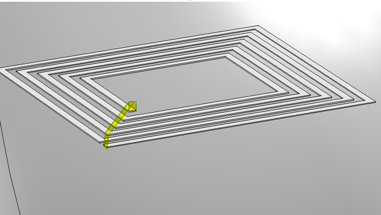

Hi Humphrey,
For modeling coils and magnetic fields due to the current in the coil correctly, you would need to have a closed loop. In your particular geometry, you could add a bridge to connect the two endings as shown in the attached image. The MUST have closed loop configuration in the geometry is discussed in this latest blog post:
www.comsol.com/blogs/modeling-coils-in-the-acdc-module/
You could remove the small section of that bridge in the Magnetic Fields physics and apply the Single Turn Coil in the coil geometry with "Boundary Feed" and "Ground" as done in this inductor example (www.comsol.com/model/modeling-of-a-3d-inductor-10299).
