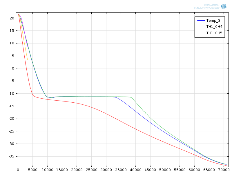

i use Comsol V4.2a, In Results there is Tables, i would like to insert new Table, and then i want to import my Data into this Table, but i don't know what kind of Format?
Do you have ideas?
Thanks you very much
the Table is populated automatically when you calculate "Define Probe" data or when you define Results Derived Values ... Try a right click on the Derived data and calculate something useful, i.e. the surface of a element by integrating over a boundary (in 3D) of the operand 1 (simple example easy to verify to start with)
Thanks for your answer.My idea ist that when you have a table of experiment (i.e *.xls, *.dat,*.txt...), you can import into the Result, then when you run your Modell, you can compare your result of Simulation with the Data of experiment. you can see in the attach file, the yellow and pink line are result of Simulation and the different lines are result of experiment. The format of this file can be *.txt or *.csv.
For example:
% File: Experiment.txt
1 21.4379997253418 21.4899997711182 21.55299949646 21.488000869751 21.4440002441406 21.4990005493164 21.5949993133545 22.69700050354
119 21.6352005004883 21.3376998901367 21.5445003509521 21.5062007904053 21.4645004272461 21.5466003417969 21.6525993347168 21.9328994750977
237 21.5757007598877 21.4720001220703 21.6172008514404 21.5347995758057 21.5081005096436 20.926399230957 21.6548004150391 20.0454998016357
356 21.5076007843018 21.2481002807617 21.5997009277344 21.5496006011963 21.3297996520996 20.1819000244141 21.6119995117188 17.8924007415771
474 21.4606990814209 20.9230995178223 21.593599319458 21.5757999420166 21.0433006286621 19.2859001159668 21.5632991790771 16.8924007415771
592 21.2175006866455 20.6334991455078 21.4689998626709 21.4855995178223 20.6396007537842 18.3082008361816 21.5403995513916 15.1507997512817
711 21.0100994110107 20.1448001861572 21.3588008880615 21.2950992584229 20.2367992401123 17.2724990844727 21.4027996063232 13.5739002227783
829 20.7943000793457 19.7229995727539 21.13450050354 21.082799911499 19.8227996826172 16.2073001861572 21.2614002227783 11.6111001968384
Best regards
QTran
you can even do more :)
If you import your experimental results into a piecewise or interpolation function, then you can define a material property variable as a ODE dependent variable and solve in a mean square way to adapt a particular variable or property to your experimental data.
