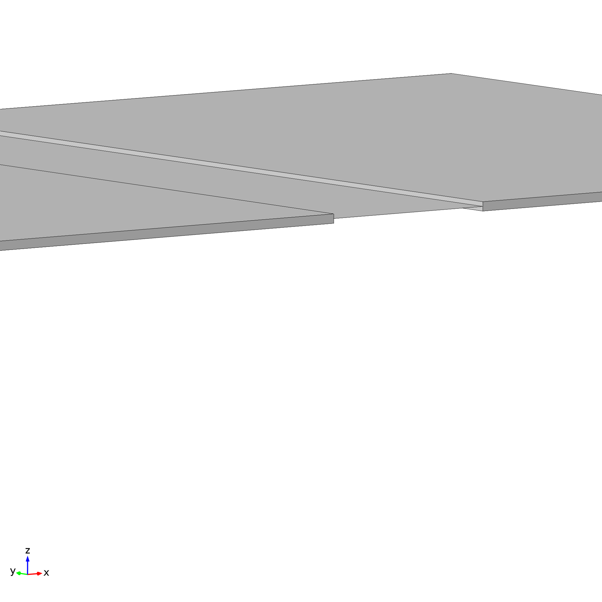

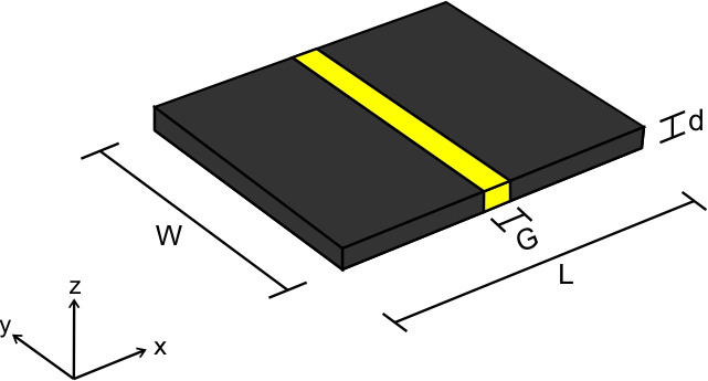

I've been trying to simulate a rectangular dipole, but I want to simulate with lumped port and it has thickness. I simulated using work plane and a lumped port without thickness, but the thickness of antenna influence on input impedance. I used Perfect Electric Conductor condition.
