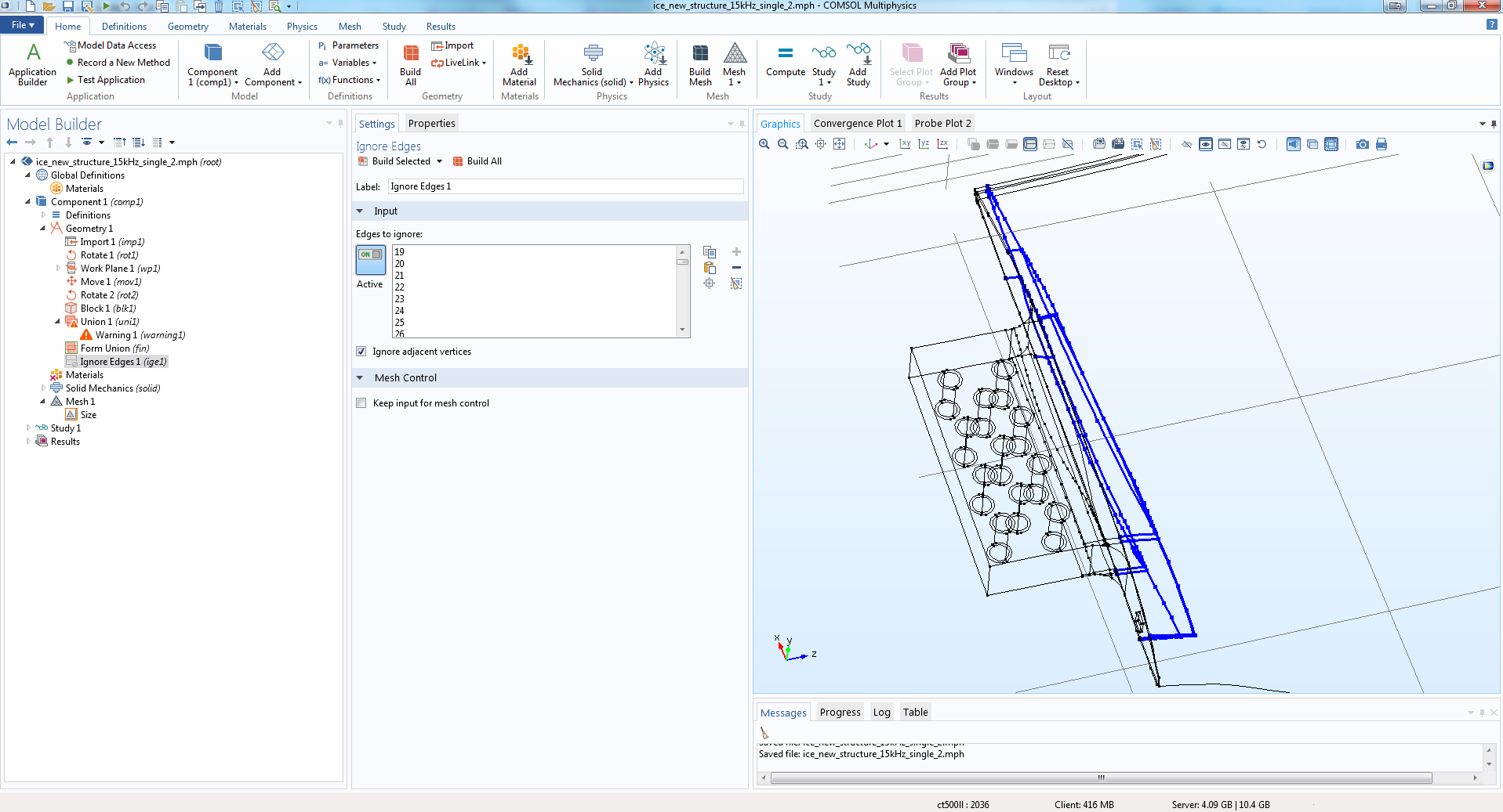

Right click on "Geometry 1" and choose:
Virtual operations --> ignore edges
Add all the unnecessary edges as shown in the attached picture
its not perfect yet but it clears the way forward :-)

This works. Many thanks.
