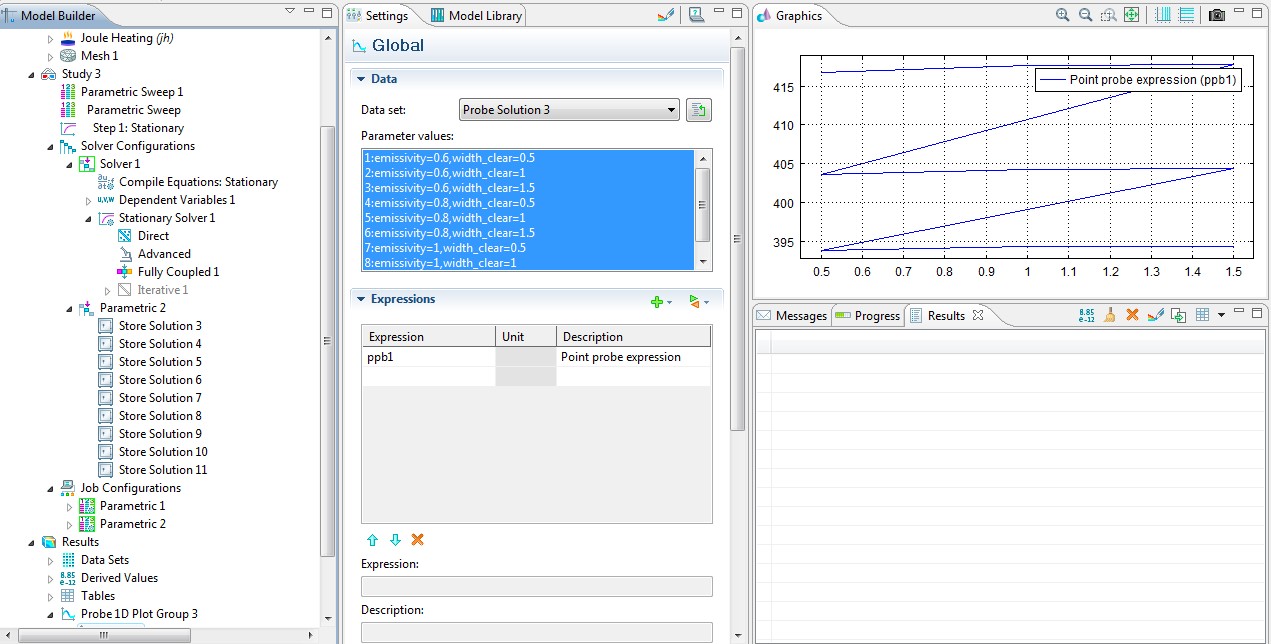

I guess you mean, I should do 2 parameter sweeps in one study?! I did, like shown in the attached screenshot. The sweep itself works, but if I want to plot, I can not select the results belonging to each parameter (e.g. emissivity). Just all results are plotted in the same plot.
Thanks for your response. I'm using 4.0a. I could manage to get the desired plot, but not in a "comfortable" way: I am using different studies for one parameter (e.g. emissivity), which I have to change by hand. In these studies I make then a sweep for the second parameter ( e.g. beam length). As a result I get different solutions which I can combine in a plot group. As the beam length should have a higer resolution than the emissivity (3 different values are ok), this approach is reasonable for me, but surely there must be a better way. I guess you mean, I should do 2 parameter sweeps in one study?! I did, like shown in the attached screenshot. The sweep itself works, but if I want to plot, I can not select the results belonging to each parameter (e.g. emissivity). Just all results are plotted in the same plot.

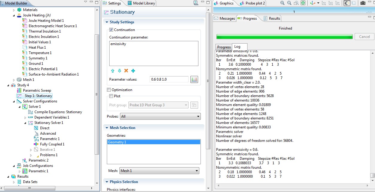

then leave the geometrical parameter loop in the "external parametric" sweep, and check the "extension - continuation" box on the stationary solver (new feature n V4) and add the physical variable parameter here, this will make an internal sweep for each external geometrical sweep

I understood and implemented your idea with an outer "parametric sweep" and an inner "continuation parameter sweep".
Unfortunately, a solution could not be found. The solver starts, but stops with this message:

Hello, thanks for your help Ivar. I understood and implemented your idea with an outer "parametric sweep" and an inner "continuation parameter sweep". Unfortunately, a solution could not be found. The solver starts, but stops with this message: Invalid property value. - Property: solnum 'Solution' is an array of integers. - : "" I tried all direct solvers with different tolerances (0.9 - 0.001) and also refined the mesh (minimum element quality now0.0083). For a "manually sweep" on the other hand, with all the different combinations I could find a solution. Any ideas?
