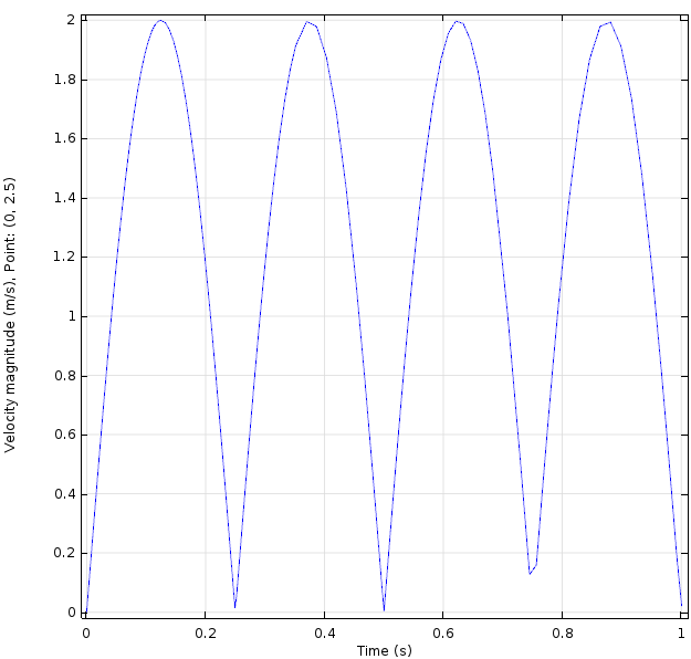

I would like to set up an inlet that produces oscillating flow (going from positive values to negative ones) in my model. When I add the expression
2*sin(4*pi*t[1/s])
to the inlet velocity field I get out only the absolute value of that expression. See the attached picture.
How can I get both positive and negative values for velocity at an inlet?

You are plotting the "Velocity magnitude".
Hello Ben, You are plotting the "Velocity magnitude". Jeff
