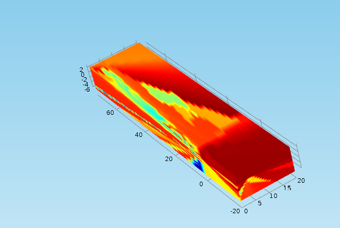

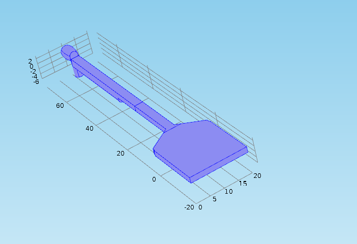

Posted: 9 years ago 2016/08/05 1:16 JST
Thank you very much! I tried what you suggested, but I can't get where I want to. When I plot the temperature COMSOL shows a block with the interpolated temperature (screenshots in the attachment). Somehow I'm not able to plot the temperature only at the part section.
What I did so far:
- Create the part in COMSOL
- Mesh part
- Export mesh to another Software
- Mapping of the temperature results onto the mesh
- create .txt-File with x,y,z,T Data
- Import .txt-file via Interpolation
I expected that COMSOL only plots the temperature inside the part, based on the coordinates it is getting from the mesh/Excel-File.
I would be greate if you or someone else could help me with this!
Thanks...
Thank you very much! I tried what you suggested, but I can't get where I want to. When I plot the temperature COMSOL shows a block with the interpolated temperature (screenshots in the attachment). Somehow I'm not able to plot the temperature only at the part section. What I did so far: - Create the part in COMSOL - Mesh part - Export mesh to another Software - Mapping of the temperature results onto the mesh - create .txt-File with x,y,z,T Data - Import .txt-file via Interpolation I expected that COMSOL only plots the temperature inside the part, based on the coordinates it is getting from the mesh/Excel-File. I would be greate if you or someone else could help me with this! Thanks...
