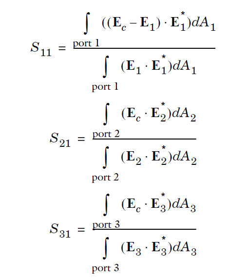

From the RF user guide manual, the S11, S21, and S31 can be calculated using the following equations (attached below).

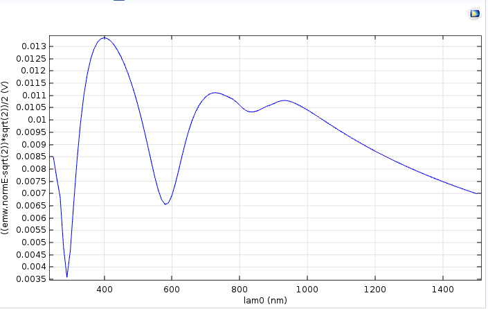

S11 = line_integration_along_the_input_port_length( (emw.normE-sqrt(2))*sqrt(2)) / 2

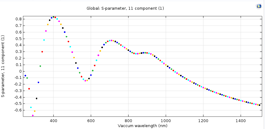

The results (attached below) for the S11 calculated by equation is not similar to that obtained by COMSOL in the post-processing list (attached below).
