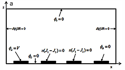

Whereby the model is setup as:
Comsol boundary conds.png attached

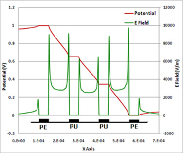

Generating an E-field and potential distribution as:
1-s2.0-S0956566311005069-mmc1.jpg attached

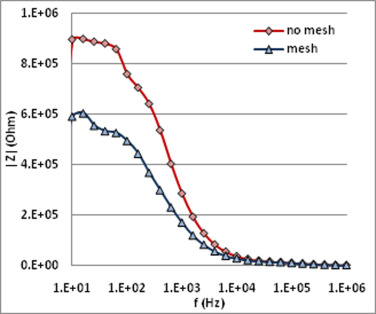

Resulting in the following dispersion mechanism being observed:
Dispersion at low frequencies.jpg attached.
Now, I get the same E-field and potential distributions, but I do not get the same dispersion, my impedance is just a flat line. This is because Comsol isn't taking into account the fact that the permittivity is frequency dependent.
