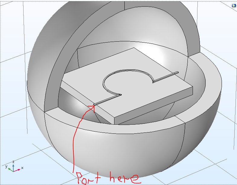

I have a very easy model of microstrip antena (prntscr of model is attached) that i d like testing but i failed on add microwave port on it. I try add Lumped port (in real we have omega shape anthena where is microwave added by coaxial, but i d like make it very easy - input power is 1W).
But there is error
Uniform lumped port should be placed between two conductive boundaries.
- Feature: Type: Lumped Port
Tag: lport1
Operation: LumpedPort (lport1
Can you help me please?
Thanks

the lumped port should be between two perfect electric conductors, right click on EM frequency domain and choose perfect electric conductor boundary condition, choose 2 boundaries and the lumped port should be between them.
Best regards.
Hi, the lumped port should be between two perfect electric conductors, right click on EM frequency domain and choose perfect electric conductor boundary condition, choose 2 boundaries and the lumped port should be between them. Best regards.
