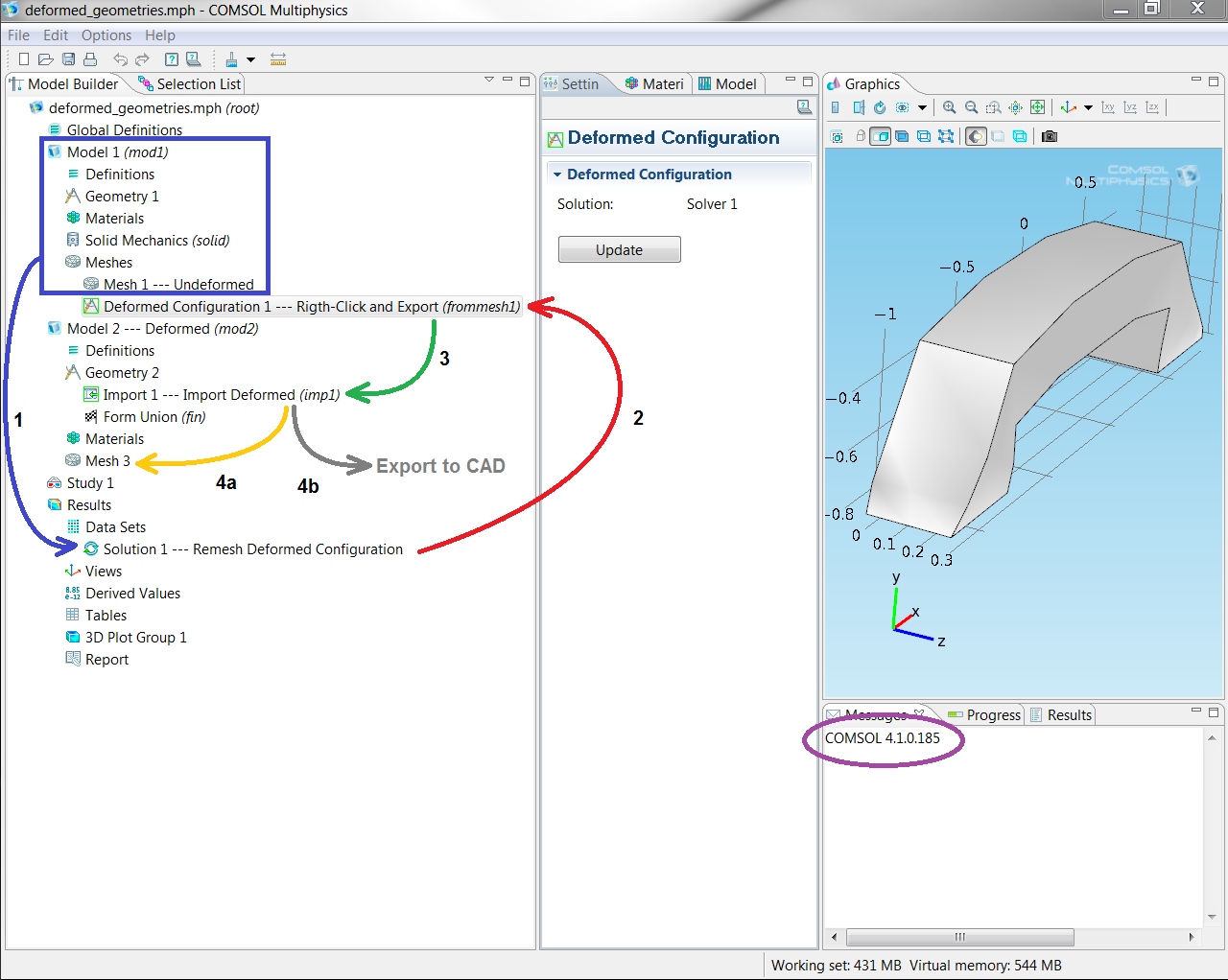

Hi Austin
Have a look at the attached picture on how to remesh a deformed geometry and export to CAD or reuse it in a new model. This was done with version 4.1.
Zoran
Hi Austin Have a look at the attached picture on how to remesh a deformed geometry and export to CAD or reuse it in a new model. This was done with version 4.1. Best regards, Zoran

Posted: 1 decade ago 2011/12/02 23:14 JST
Hello Zoran,
I also followed the workflow to remesh a deformed geometry as you indicated on your nice outline. It all worked well in version 4.1. But now I'm using 4.2a (4.2.1.134), and just repeating the same steps, I don't get the deformed geometry but a copy of the original geometry. Maybe this is a bug in this latest release?
Hello Zoran, I also followed the workflow to remesh a deformed geometry as you indicated on your nice outline. It all worked well in version 4.1. But now I'm using 4.2a (4.2.1.134), and just repeating the same steps, I don't get the deformed geometry but a copy of the original geometry. Maybe this is a bug in this latest release?
Posted: 1 decade ago 2012/11/09 3:51 JST
I agree that this same thing is occurring in 4.3a -- e.g., the imported mesh is not the deformed mesh. Does anyone have an update as to how this should actually work in the newer versions? The workflow seems logical, and it would be nice to see it work OK.
John
I agree that this same thing is occurring in 4.3a -- e.g., the imported mesh is not the deformed mesh. Does anyone have an update as to how this should actually work in the newer versions? The workflow seems logical, and it would be nice to see it work OK. John
Posted: 1 decade ago 2013/03/24 6:20 JST
Hello Zoran,
I am also having the same issue with COMSOL 4.3. When I make the deformed mesh, it is the original geometry, not the deformed geometry. Any updates on this?
Thank you in advanced,
Adan
Hello Zoran, I am also having the same issue with COMSOL 4.3. When I make the deformed mesh, it is the original geometry, not the deformed geometry. Any updates on this? Thank you in advanced, Adan
Posted: 1 decade ago 2013/03/25 3:40 JST
it could be that you need to turn on the solver "non-linear" geometries in the later versions, it's just a guess from my part as I'm not by my WS so I cannot check, but there was a change in the later versions on the way the spatial and material frame was handled (and from where)
Hi it could be that you need to turn on the solver "non-linear" geometries in the later versions, it's just a guess from my part as I'm not by my WS so I cannot check, but there was a change in the later versions on the way the spatial and material frame was handled (and from where) -- Good luck Ivar
