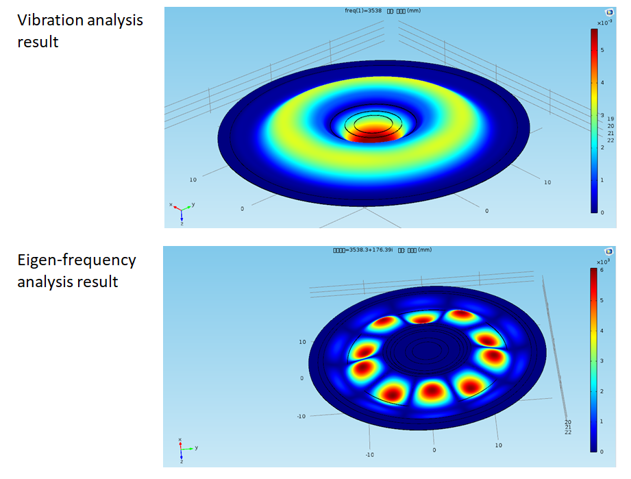

I am simulating the vibration of a speaker membrane driven by a coil. However, I cannot get any circumferential modes of vibration in my simulation result.
I have set the properties of the membrane correctly (according to a real speaker membrane). And circumferential modes of vibration is obvious in the real speaker testing. The speaker is a circular structure and therefore my model in comsol is axial symmetric. Also I adopted a 3D structure in order to get the vibration modes. Is it that circumferential vibration modes cannot be obtained for a axial symmetric structure in simulation? Or my settings are not correct?
By the way, the vibration modes obtained in eigen frequency analysis agree well with the real speaker testing. In addition, I tried to add a small part to break the symmetry but the result had little change. Anybody can help?
Thanks a lot in advance for your help. Have a nice day.
Best, June

Hi, Edgar. Thanks for your kind reply.
Sorry that I don't quite follow you. Besides the geometry, where else shall I respect the symmetry? Although my model is axial symmetric, I have to the 3D model so that I can get the circumferential modes. What do you think leads to the lack of circumferential modes in the simulation result?
I tried to add a small part on the membrane to break the symmetry but the result showed little change. Is there any possible solution to this kind of problem? After all, speakers are normally with a circular structure (although real speakers are not prefectly axial symmetric). So this problem is quite typical. If the vibration simulation does not show circumferential modes, the sound simulation of the speaker will, in turn, be incorrect.
If this problem exists intrinsically, it would be very interesting, and important as well, to come up with a possible solution.
Best, June

Hello June,
If I understand your posts correctly, you are performing an eigenmode analysis and carrying it out as a full 3D analysis of an axisymmetric structure, not as a 2D axisymmetric analysis of an axisymmetric structure. If that understanding is correct, then yes, such a model is capable of finding all eigenmodes, not just those that are axisymmetric.
If your eigenmode analysis model is not showing you certain modes that you expect, the most likely scenario is that those modes are at frequencies past the ones where you are telling COMSOL to look. By default COMSOL returns the 6 modes with the lowest eigenfrequencies. It could be that for your structure the circumferential modes are not among the bottom 6, in which case you would need to set up your solver to ask COMSOL to return more than 6 eigenmodes.
If, on the other hand, what you are saying is that the eigenfrequency analysis model does find all the expected modes, including the circumferential ones, but that those modes do not appear to be involved in a subsequent frequency-response analysis, then one likely scenario is that your loading simply does not excite those circumferential modes or excites them much less than it excites the other modes.
PS: If Edgar and I misunderstood your work, please post the mph file so we (and other Discussion Forum users) can took a look at it for ourselves.
