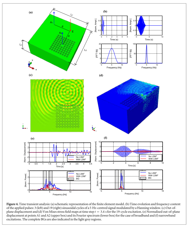

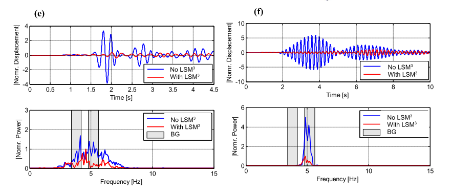

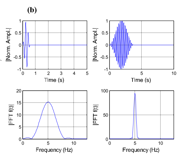

Dear Sir, I want to reproduce simillat plot inside COMSOL Multiphysics. I have primary data with me but I am stuck in this stage how I should reproduce this plot. Which module I should use? Inside that module which function/option i should use for plotting it? I guess it could be Solid Mechanics, Frequency domain but I am not very sure and confused as I have tried but cannot reproduce this type of plot. I did not saw any amplitutde (dispalcement) variable inside Global Evaluation so that I can plot frequency corresponding to that. Please help me in producing simillar plot which is attached with this message.
