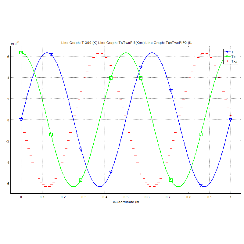

You can get your higher order derivatives if you introduce a new PDE: (1D) u=d(d(T,x),x)
-> add PDE coefficient form
a=1
f=d(d(T,x),x)
leftover coefficients =0
then you can get your 3rd and 4th order x-derivatives by 'ux' respectively 'uxx'
have a look at the attached file (V3.5a) with a 1D example.
But still, I don't understand, why it isn't possible to get a 3rd order derivative, if quintic order lagrange elements are used.

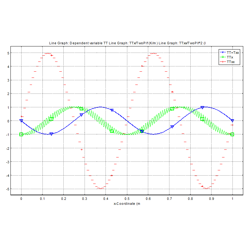

In v4.1.0.85 it gives this:
OK up to third derivative, 4th has a scaling issue ?
each derivative is divided by 2*pi*freq for normalization.
Why is TT=PDE of Txx renormalized to 1? ===> it's not, I was too quick, I forgot about my renormalization ;)
But why is TTxx at *5 the expected amplitude ===> not understood
Having (less?) fun COMSOLing
indeed, the 4th derivation is too high (approx. 5 times). If I switch to quartic elements for 'T', there is no 'scaling' issue anymore. -> Txxxx/((2*pi*f)^4)=T
So it's a numeric issue?!?
That's what you mentioned?
Having (even more!) fun COMSOLing ;)

Even though you use quartics, you can't get the 4th derivative out of the original variable 'T', because 'd(Txx,x)' and 'd(d(Txx,x),x)' are always zero. Therefore I have to introduce a new PDE ('u').
best regards
Sorry, when translating to 4.1 I mixed up u and u2, so I renamed them T and TT. Then as I was playing with the shape functions of u2 or my TT I did not manage to improve things, what I forgot was that the source is u (or my T) and I did only leave it as a quadratic.
Now it could be that in V4 the higher derivatives with d(uxx,x) are calculated correctly, I will have to check so one do not need to add the PDE, it would be rather logical (for me) that a higher order shape function allows to take higher derivatives without any additional PDE artifact
