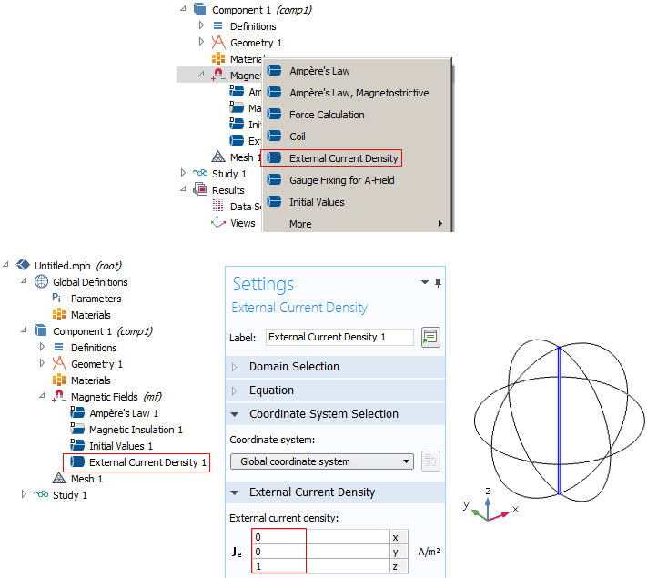

External Current Density on the domain level is available in the (mf) physics interface. Just right-click Magnetic Fields (mf) node and you'll see it, as shown in the attached image.
Sergei
Henry, External Current Density on the domain level is available in the (mf) physics interface. Just right-click Magnetic Fields (mf) node and you'll see it, as shown in the attached image. Regards, Sergei
