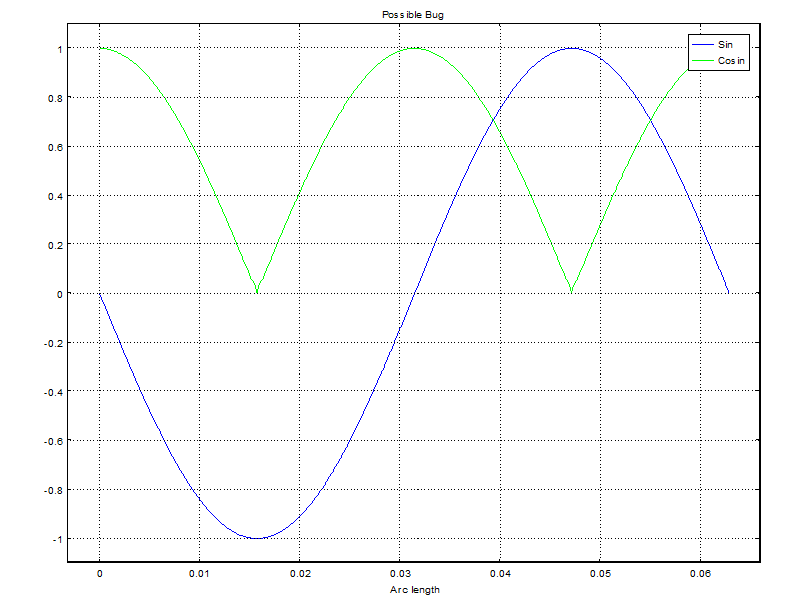

I have been having a funny issue lately.
I have defined a variable called 'angle' as the arcsin of the ratio of y over the radius of a circle: angle=asin(y/radius)
Whenever I ask to plot sin(angle) everything works fine but when I ask to plot cos(angle) I get a funny result.
I did find a workaround but I suspect this may be due to a bug in the way Comsol handles geometry definitions.

Thanks for the reply. But no I do not define the variable anywhere close the origin. Actually, the circle is centered in (0,0) so that guarantees no singularity.
I am afraid what you said just confirmed my suspicions: it does seem to be a bug.
Please look at the picture I attached and you will see what I mean by funny behaviour!

Asin returns a value between -pi/2 and +pi/2, so the cos of that is always positive. What's so surprising?

Thanks! So that was the rub! Well, I would say that is surprising that you don't get that mentioned in the definition of asin in the Comsol Local help, where they state:
asin inverse sine asin(x)
under 'Mathematical functions'
So a little more explaining would be in order for the next edition of the Local help, because it is definitely counter-intuitive to have to imagine that you asin is limited between -pi and +pi...
One more question then, what are the boundaries for atan? (Again it is not explicitly stated) 0 and pi? -pi and 0?

That's the usual definition of arcsin, see for instance Wikipedia: en.wikipedia.org/wiki/Inverse_trigonometric_functions

I am curious why standard? I am sorry but as a mathematician-engineer such a definition does not make much sense, whenever I solve for an ODE or a PDE I don't think an inverse trigonometric function is usually defined between two angles.
At any rate atan is then limtied between -pi/2 and pi/2?

the easiest is to test it out with the analytical function functionality (and plot otion) og V4.
test also atan2(,) I believe its defined for a "full turn"
again this is ususal math definitions. In the function definitions you have ways to make them periodic again
