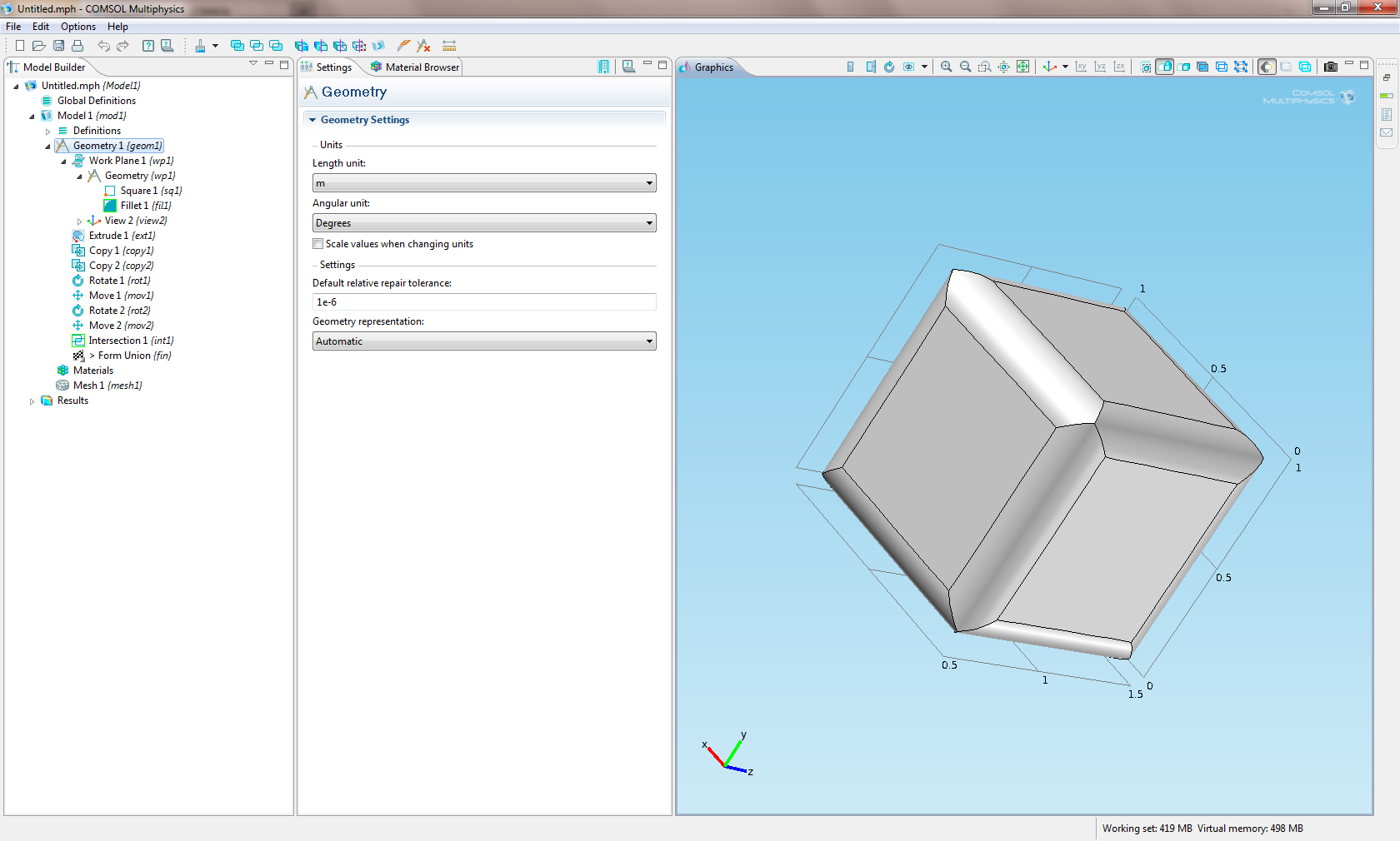

If you are trying to fillet the edges (not just round the vertices) of your cube, you can achieve that by filleting a square in a workplane, extruding that, making two copies of that extruded object, moving and rotating them appropriately and taking the intersection of those three objects, see the attached screen shot.

Posted: 1 decade ago 2011/05/11 0:45 JST
Jean,
I want the same model, which you showed me. Can you please explain it a little more (parameters etc) as i am using comsol 3.5a.
Thanks.
Cecil
Jean, I want the same model, which you showed me. Can you please explain it a little more (parameters etc) as i am using comsol 3.5a. Thanks. Regards, Cecil
Jeff Hiller COMSOL Employee
Posted: 1 decade ago 2011/05/11 3:00 JST
There's nothing to it, really. In a workplane you just create a square and fillet its corners. Then you extrude that shape; that gives you a square column with rounded edges. You make two copies and rotate them 90 degrees so that the three columns are aligned with the x,y, and z axes. Finally you move them so their intersection is the dice you are after, and take the intersection.
If you update to 4.1 I can send you the mph file.
There's nothing to it, really. In a workplane you just create a square and fillet its corners. Then you extrude that shape; that gives you a square column with rounded edges. You make two copies and rotate them 90 degrees so that the three columns are aligned with the x,y, and z axes. Finally you move them so their intersection is the dice you are after, and take the intersection. If you update to 4.1 I can send you the mph file.

Posted: 1 decade ago 2011/10/18 20:03 JST
follow the steps under the model builder geoemtry tab, of the dice.png picture, and you will find out ;)
Hi follow the steps under the model builder geoemtry tab, of the dice.png picture, and you will find out ;) -- Good luck Ivar
