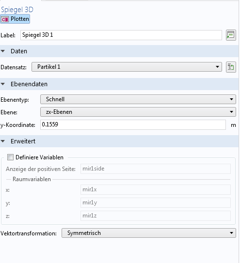

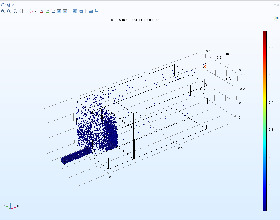

I have successfully plotted particle trajectories in 3D and I would like to mirror the results using the Mirror Plot 3D function, however when I do this only the geometry gets mirrored but not the particle trajectories as well. I have included some screenshots below to clarify the situation.

Dear Summer, the mirror data set does not support particle trajectory plots. However, you can use the trick in the attached model to accomplish the same thing. It basically involves a second Particle data set which flips the sign of the y-component of the particle position.
