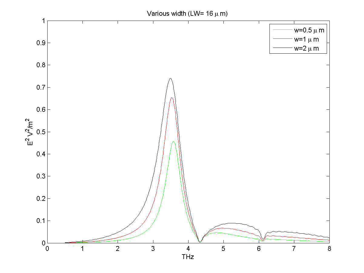

After days of trying, I got stuck because I cannot have the same response (in terms of E^2) as the one i get with the other program, with the same geometry, and same materials. I attached this response too.

- There is a way to plot the same expression (E^2) to have better comparison?
