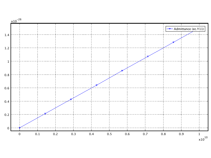

I was able to simulate my capacitor in a time-harmonic analysis in version v3.5a. Calculating the capacitance with the formula given in the microstrip example (C11=imag(Y11)/omega) gives me always the same capacitance, no matter what frequency I apply at the input port. I checked the input signal by drawing it versus the time, so I really see a sinusoidal signal with the desired frequency. This can't be correct, since the capacitance is frequency-dependent. Btw, I went up to 1 GHz.
Then I tried a frequency domain analysis in v4.0a. Again, I simulated up to 1GHz and I calculated the Capacitance with the same formula. Again, I get a frequency-independent capacitance which can't be correct. I plotted the Admittance Y11 which shows a perfectly linear increase with the frequency, but I would expect something else due to fringing fields etc.
So to summarize: No matter if I try a DC analysis, a time-harmonic analysis or a frequency domain analysis, I always get the same capacitance, no matter which frequency I apply at the input port.

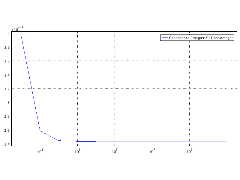

Posted: 1 decade ago 2011/06/17 20:25 JST
Hi John, thanks a lot for your input, I really appreciate it!
So I had the same idea and what I did was, I simulated the capacitor (14 microns high) on a 100um pyrex substrate (epsilonr=6.4) with another 100um air box on top (epsilonr=1).
The result is almost the opposite from what I would expect, the capacitance gets smaller (see attachment). The frequency range was from 1Hz to 100GHz by going up with a factor of ten (1Hz, 10Hz, 100Hz, ...).
Pretty strange...
Hi John, thanks a lot for your input, I really appreciate it! So I had the same idea and what I did was, I simulated the capacitor (14 microns high) on a 100um pyrex substrate (epsilonr=6.4) with another 100um air box on top (epsilonr=1). The result is almost the opposite from what I would expect, the capacitance gets smaller (see attachment). The frequency range was from 1Hz to 100GHz by going up with a factor of ten (1Hz, 10Hz, 100Hz, ...). Pretty strange...

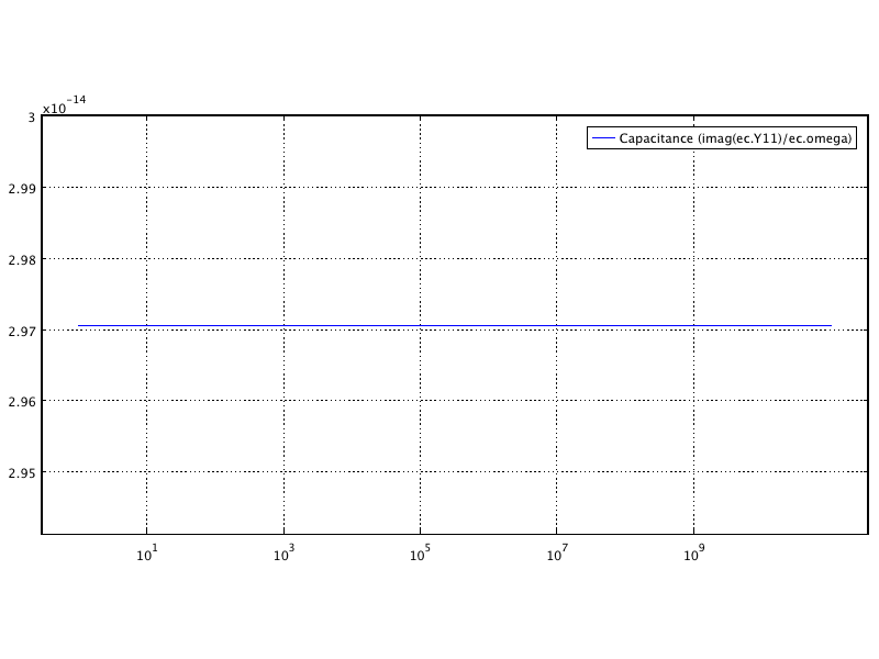

Posted: 1 decade ago 2011/06/17 20:32 JST
And if I now set the mesh to extremely fine, I get what I got in the beginning, a constant capacitance...
Posted: 1 decade ago 2011/06/17 22:47 JST
Hi Jimbo,
of course COMSOL calculates the stray field (you call it fringing field). The difference between an analytical calculation and COMSOL is that COMSOL cannot calculate the stray field at large distances because the FE model must be finite.
In the AC/DC approximation the field topology does not depend on frequency, also the stray fields are frequency independent.
It is the nature of the quasistatic approximation that the relation of structural dimensions and wavelength are ignored.
You must probably use RF to see those effects you are expecting.
