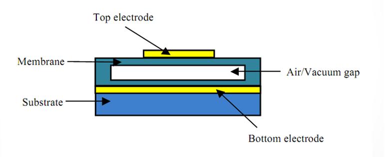

Hi all, I'am Mohamed Aref, and want to simulate cMUT and compare results with analytical solution, after setup model and get simulation results, i found large difference between analytical solution and simulation results (error in model setup).
cMUT is simply a parallel plate capacitor and I put voltage on the top plate and ground on button one, see the attached image.
This is the steps i done:
1- Modeling
2- Materials
3- Physics
>> in physics, first calculate force from (Force Calculation) and then set this force as boundary load,
Let's first compare between deformation in membrane due to electrostatic force
>> From analytical deformation at voltage=202 volts equal 0.5 um, and from simulation equal 4*10-11 m
so there is difference by factor 10^-4
I think that is error due to error in force calculation as it depend on the type of dielectric between the to electrodes which is air, as when i modeling the cMUT i can't define that this gap is air.
The model is attached, and i'll wait your replays, Thanks to you.
Best regards.
