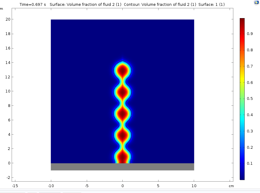

I have the same problem. I tried to change the viscosity of the liquid. Entered step function with the transit zone of Delta T (50degC). But unfortunately Level Network does not react to it.
