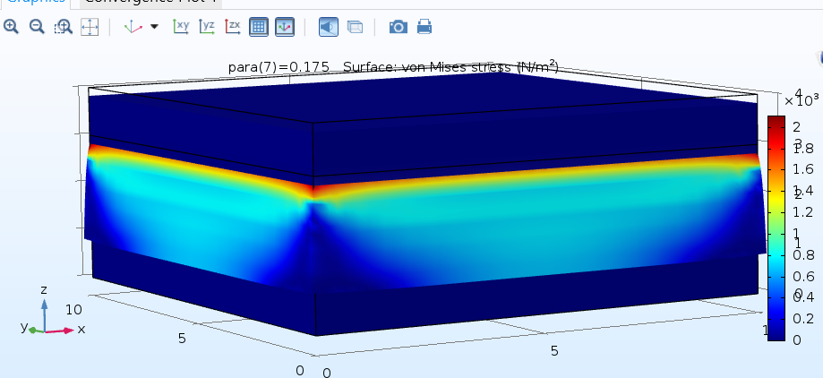

Hello, i just started to learn how to use Comsol and I have a question. I started with a simple simulation: Two steel plates on the top and bottom, some flexible material in between. The top plate moves down and deforms the flexible material in middle, the bottom one is fixed.
Problem: While the flexible material stays in fixed contact with the top plate, it is pushed over the edge of the bottom plate. I would like to fix the flexible material also to the down plate. Or to say in a different way, the defomation should be symmetric.
In the attached picture one can see what i mean: while the top interface is fixed, the bottom one changes.

Edit: Under Solid Mechanics, in the Free node, the selection is active - it is "overridden" by the contact. Can this be the problem?

Markus,
that's it probably. Just try to disable the contact node und change the finalization step in the geometry from assembly to union.

Thanks, that worked :) (my email/acc was changed)
