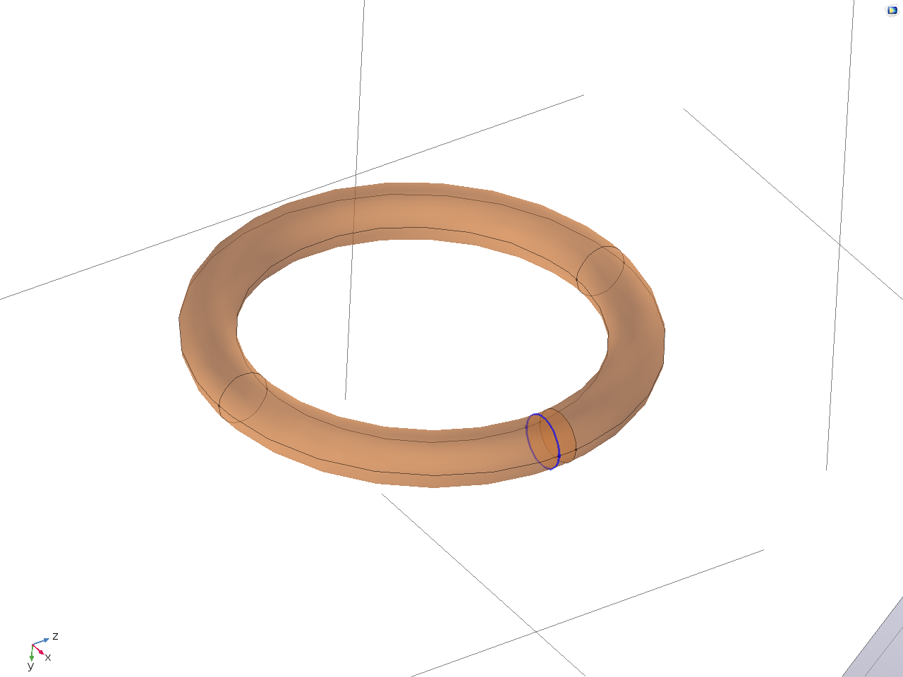

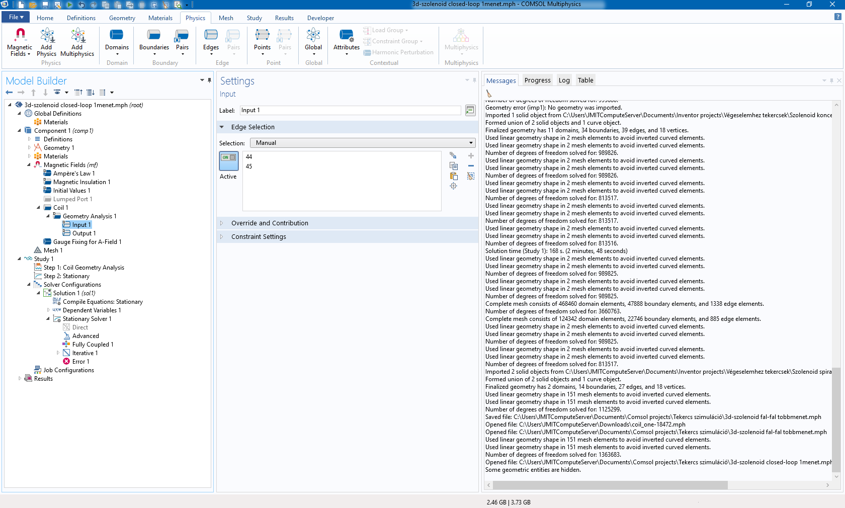

I would like to add an excitation signal to my simple inductor but I am very confused how to do it. I have read the ACDC reference manual and several online notes, but none of them seems working to me. (or I misunderstood them) I would like to drive my coil with 10A and analyze its magnetic field but I run into different errors and the simulation always aborted. I have attached some pictures of the setup.

thank you for your quick reply. I have checked the Helmholtz resonator pdf.(I cannot open 5.4 project in my 5.3 Comsol version.) In the pdf, it is written that the Helmholtz inductors are modelled by Homogenised multi-turn coils but I would like to analyze phenomenons related to single-coil model. (even the coil made up by several turns)
  1. I have tried Lumped port to put excitation in, but I have always received errors like:
    "Uniform lumped port should be placed between two conductive boundaries." even I think I select the boundaries in between the conductive cooper ring parts in a right way.
  2. I went through the Coil condition with single-turn coils, but after a while the solver stops and throw an error like:
    "Numeric coil Coil 1(coil1) not solved for. Solve it in a Coil Geometry Analysis step." It seems to me that the program cannot generate the current path in the conductor because I cannot see the current direction after selecting the Input and Output edges. Actually, it is not clear for me why the Input is requiring edge instead of boundary (surface).
I have attached my project file.
Kind regards, Bence
