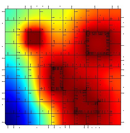

Firstly, I have been set up the paramters which are related to concentration variable and added the concentration to "concentration" edge. As a result , the edges are the more deep color in diffusion model as attached file, but I want to set up the concentration variabe for the domain which is in the edge that i have mentioned. What should I do? Add the PDE equation or something else?
Secondly, now i use 'diffusion' model to simulate the process that the bigger molecular diffusions from the vessels through vessel walls (the much deeper edges). Should i set up the 'permeability' for vessel wall and what should i do? I have saw the 'permeability' properties in material, but it is in 'Output properties',so I think it is not right.

Indeed I would not define a concetration on the edges, but only on/for the domain(s), this should work at least for v4.2 (rather forget the earlier releases, and make your model fully from scratch in v4.2 or later, I do not relly trust 100% the tranlations between these earlier v4 versions, even if the COMSOL programmers, I admit, have done a hard job to get them compatible)
Normally, if the walls/edges/boundaries do not have any specific properties by themselves, you should "just" leave them with default "continuity" properties and work on the domains.
However if they represent "thin features" i.e. a semipermeable membrane you must adapt the boundary physics and paramaters accordingly
