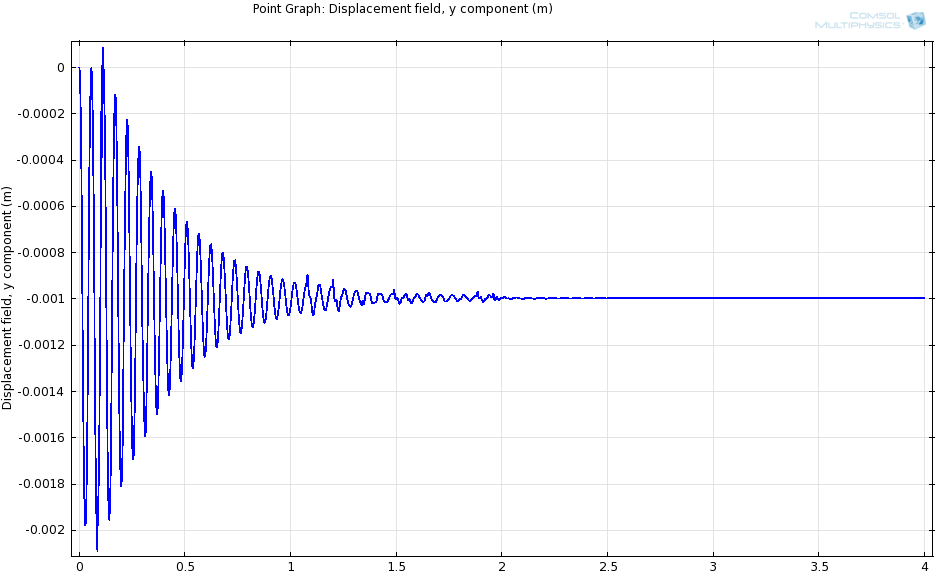

I want to model the undamped vibration of a cable (using truss element and the time dependent solver) but in spite I don't consider any damping, after a few minutes the vibration results totally damped while it should continue vibrating at its natural frequency.
The cable is pinned at both ends. I'm using the BDF time stepping method and I chose a time step which is about 1/100 of the period of vibration corresponding to the first natural frequency. The cable is under the load of own weight only.
I attach a picture of the displacement graph at the middle of the cable.
I made the same model in ALGOR and I got the undamped vibration I'm looking for.
Anyone knows where is the problem?
Thank you,
Bruno.
