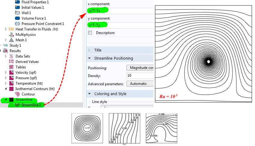

How to draw heatline using comsol multiphysics ?

Hi mukitamin717 ... plotting heatlines took me one week tweaking in comsol till a got it well, it's easy... 1- Eventually you have the streamline plot, and in the expression you have : x component: y component: you modify the above as follow: and ..... that's all eqt 24,25 from Natural Convection in an Enclosure with a Discretely Heated Sidewall: Heatlines and Flow Visualization M. Saglam1, B. Sarper2 and O. Aydin and eqt 14 from Finite Element Simulation for Heatline Visualization of Natural Convective Flow and Heat Transfer inside a Prismatic Enclosure M. S. Alam 1, 2 , M. M. Rahman 1,, S. Parvin 3 and K. Vajravelu That's what I supposed to have... Otherwise correct me !
Hi mukitamin717 ... plotting heatlines took me one week tweaking in comsol till a got it well, it's easy... 1- Eventually you have the streamline plot, and in the expression you have : x component: u y component: v you modify the above as follow: u*T-Tx and v*T-Ty..... that's all eqt 24,25 from ***Natural Convection in an Enclosure with a Discretely*** *Heated Sidewall: Heatlines and Flow Visualization M. Saglam1, B. Sarper2 and O. Aydin* and eqt 14 from **Finite Element Simulation for Heatline Visualization of Natural Convective** *Flow and Heat Transfer inside a Prismatic Enclosure M. S. Alam 1, 2 , M. M. Rahman 1,, S. Parvin 3 and K. Vajravelu* *That's what I supposed to have... Otherwise correct me !*
