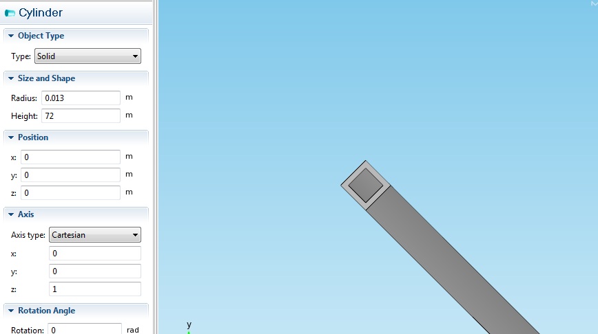

I'm a new user of Comsol and I have the following problem:
I'm is using a cylinder geometry with radius:0.013m and lenght: 172m when I build this geometry I dont have a cylinder in the grafics window but a rectangle. Why this is occuring?

Im using 3d view and comsol 4.2. In attach is a print screen of my tube.
I saw that if I use a lager radius of the tube the cilinder take your real form, but for small radius its a rectangle.
Im using 3d view and comsol 4.2. In attach is a print screen of my tube. I saw that if I use a lager radius of the tube the cilinder take your real form, but for small radius its a rectangle.
Posted: 1 decade ago 2011/10/19 11:53 GMT-4
Your cylinder has a very high aspect ratio. COMSOL by default does not accurately plot very small lines/surfaces (a very suitable setting for speeding up most 3D plots). You can override that by setting Detail = Fine under the Options menu > Preferences > Graphics. You may still run into trouble with meshing and analysis. If this is a solid consider defining a line instead and using beam elements.
