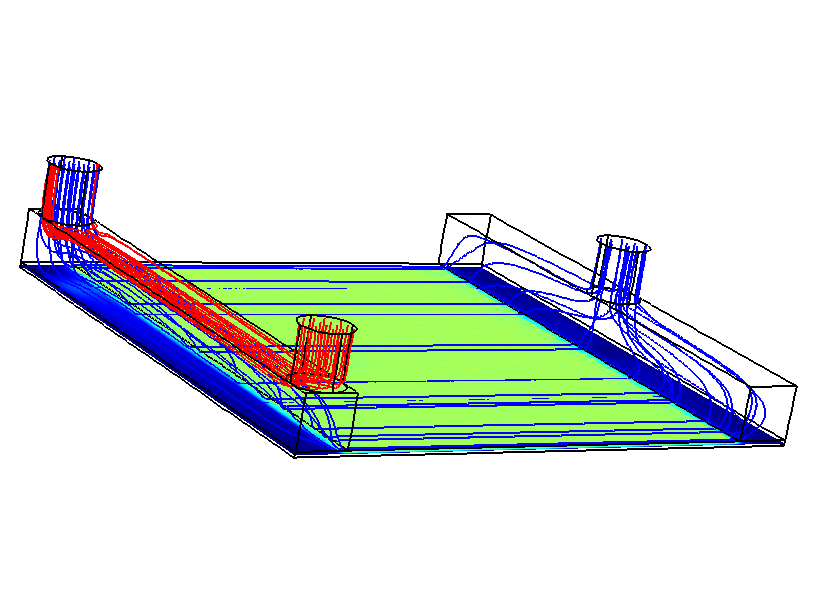

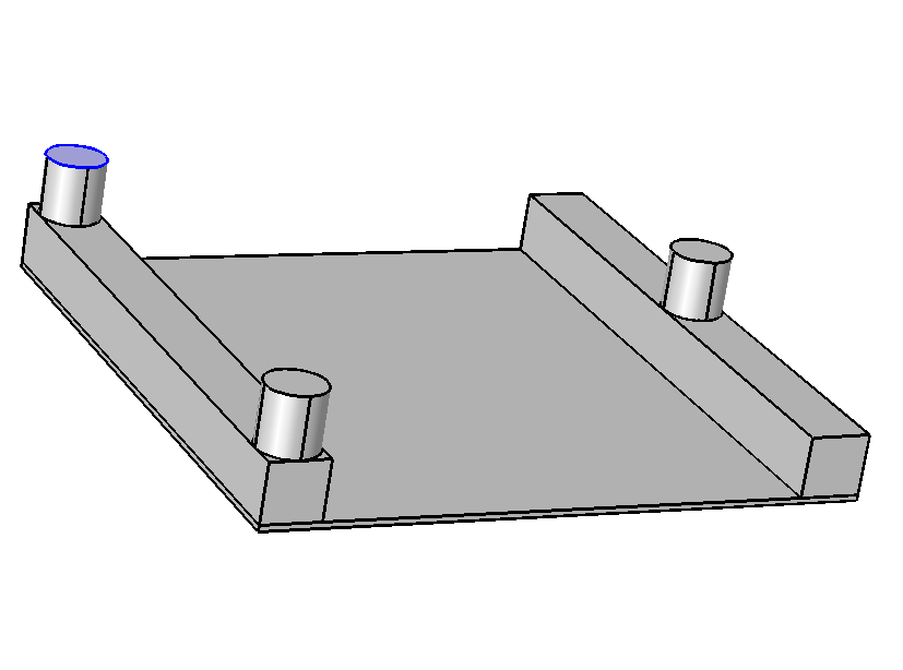

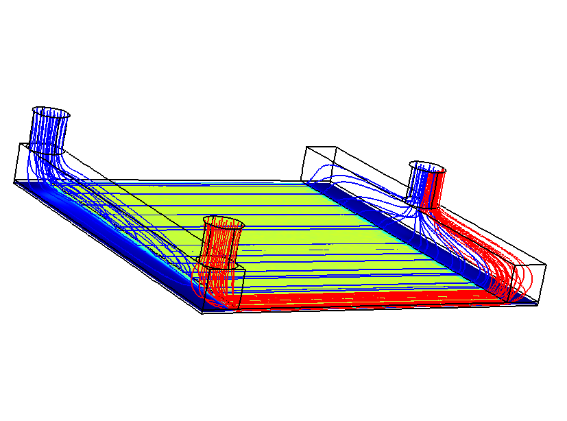

I am simulating laminar flow through a thin geometry with two inputs on one side and one outlet on the other side (see image for the geometry). When initializing the inputs via velocities I get the expected results - see the corresponding image (the upper inlet has 10x the velocity of the one below). But with pressure as inputs, the simulation results in a (back)flow between the two inputs.
Obviously I enabled "suppress backflow" for both inlets but this only seems to account for the "own" input and not the other one. I tried to add weak constraints but these can only be applied to a volume. Is there an option to define equations on a surface?

Claus, I checked your model. All boundary conditions (BC) as pressure BC can not work! Because there are differences between the pressures of the two inlets the fluid must flow out of the "inlet" with the lower pessure! There is a small pressure gradient! It is a nunmerical problem. Because water nearly is incompressible in reality backflow is prevented by pumps or valves.
May be you can use an average pressure for both inlets. Solve for the steady state flow. Then change the pressures and solve for the transient flow. This will give you a more smoother solution.
What do you want to evaluate with your simulation? Best regards Michael
