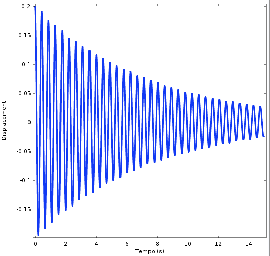

Hi, I've a problem with the mechanical simple oscillator. I do the system with node pinned, spring and mass, then I launch the calculation. I wait the sinousoidal graph, but the result is a sinousoidal graph tending to zero. I don't set a damper. Why ? Where am i wrong ?
P.s. I've attached the graph

It can be caused by numerical damping in the time-integration algorithm, even though the damping seems surprisinly strong here. If you are using BDF, try Generalized alpha instead. Solver settings, as wel as things like tolerances and time steps can affect the outcome.

Hi, It can be caused by numerical damping in the time-integration algorithm, even though the damping seems surprisinly strong here. If you are using BDF, try Generalized alpha instead. Solver settings, as wel as things like tolerances and time steps can affect the outcome. Regards, Henrik
