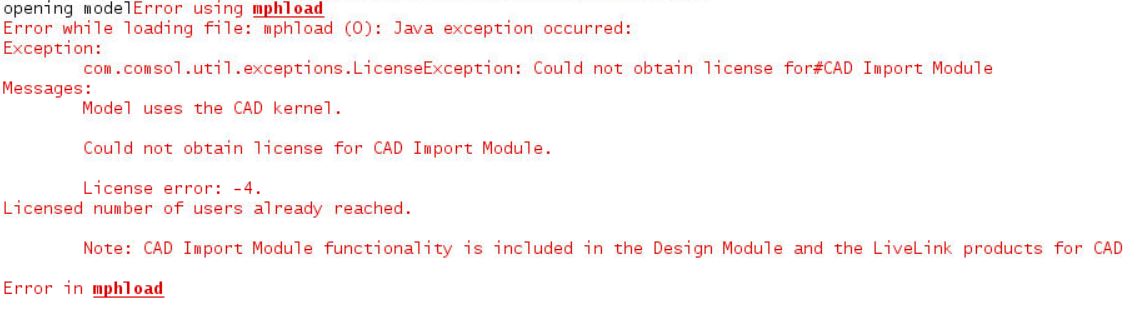

I'm using livelink with matlab to run simulations which involve opening a model. The issue I run into is that when the CAD Import licenses are used up, which my script does not require, COMSOL will throw an exception just trying to open a saved file. Interactively, when I open COMSOL and open the file myself, I get the same error, but can click "OK" on the dialog box and it opens my model. How can I effectively ignore this error in my script and continue to opening the file?

We can have a look at the error message, but it'll take some days since some things are more complcated than usual.
If you open your model in the Comsol GUI and click on the Geometry node you can change the Geometry representation to "Comsol kernel" and save the model. After this, you shouldn't see this error message again for this model.
