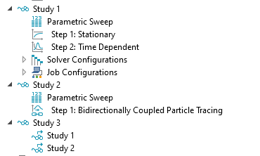

I am trying to run 2 studies in a comsol batch. In the COMSOL GUI I make a study 3 which is combining study 1 and study 2.
Study 1 : Stationary and time dependent substudies (stationary is input for TD) Study 2: Bidirectionally coupled study
Within these 2 studies I also try to do a parametric sweep (see attached image for study tree).
Study 1 seems to have no issues at all and solves sucessfully. However, study 2 encounters an error and is completely empty at the end. The error is as follows:

I am not sure what this means, I have checked all parametric properties and study properties but they are almost exactly the same as study 1 so I am not sure why I does not solve sucessfully.
