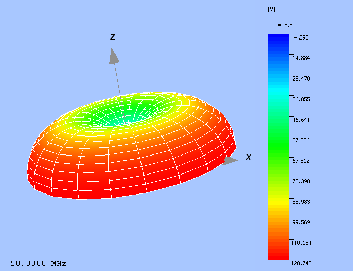

I have the same experience about far field calculation. However I found that calculation times get reasonable when you avoid 3D plots. If you just calculate the usual Azimuth and Elevation plots in polar coordinates you have normal postprocessing time demand.
The 3D plots are looking nice but what is mostly needed in antenna design are the polar plots.

And about the 3D plot. I tried to recalculate results from a other simulation program, see attached picture. I want to compare the simulation of the both programs. And actually it should be same.
