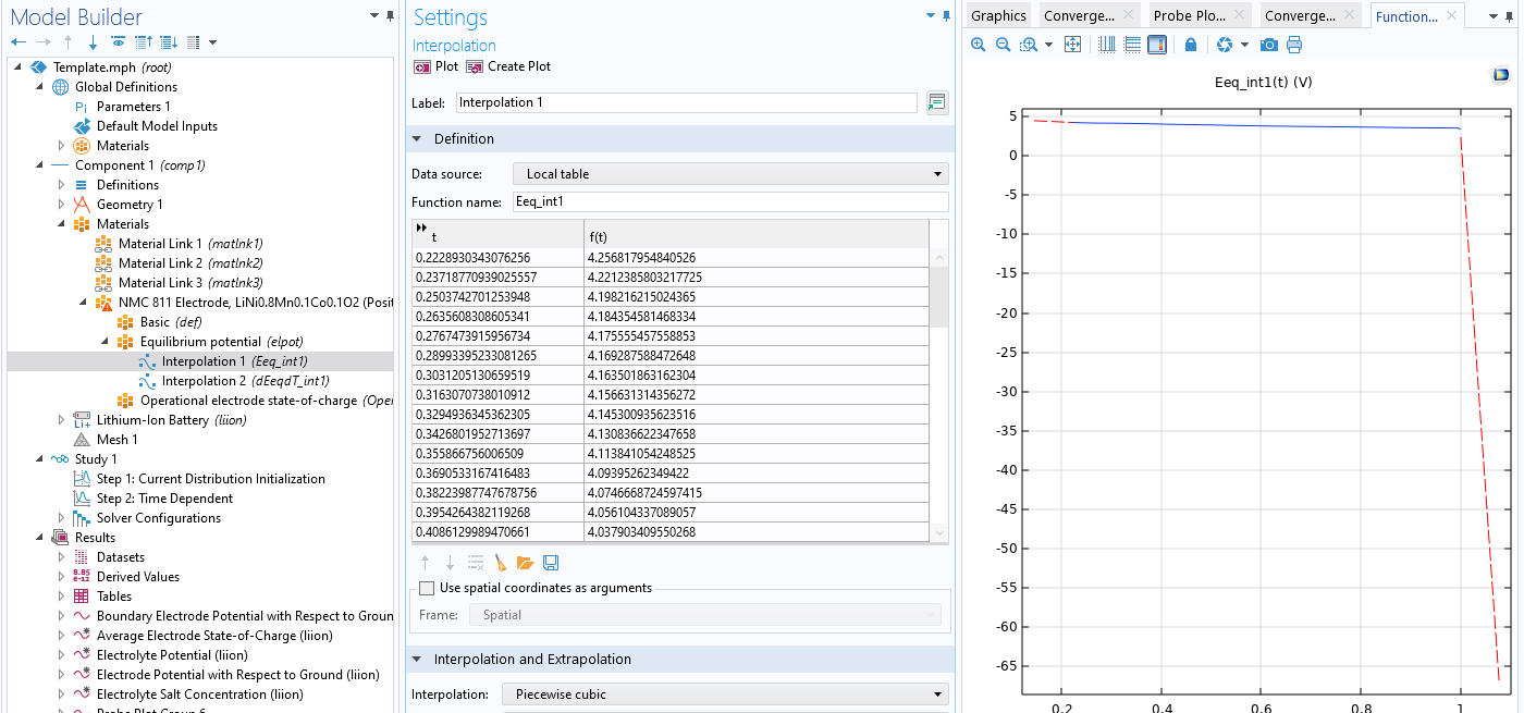

I think the best way is to generate the data point from 0 to 1 SOC. and copy the data point into comsol to generate a point. like what they did for all the other materials

@XiuQun Cui from where i can generate the data. I am only doing numerical simulation,
