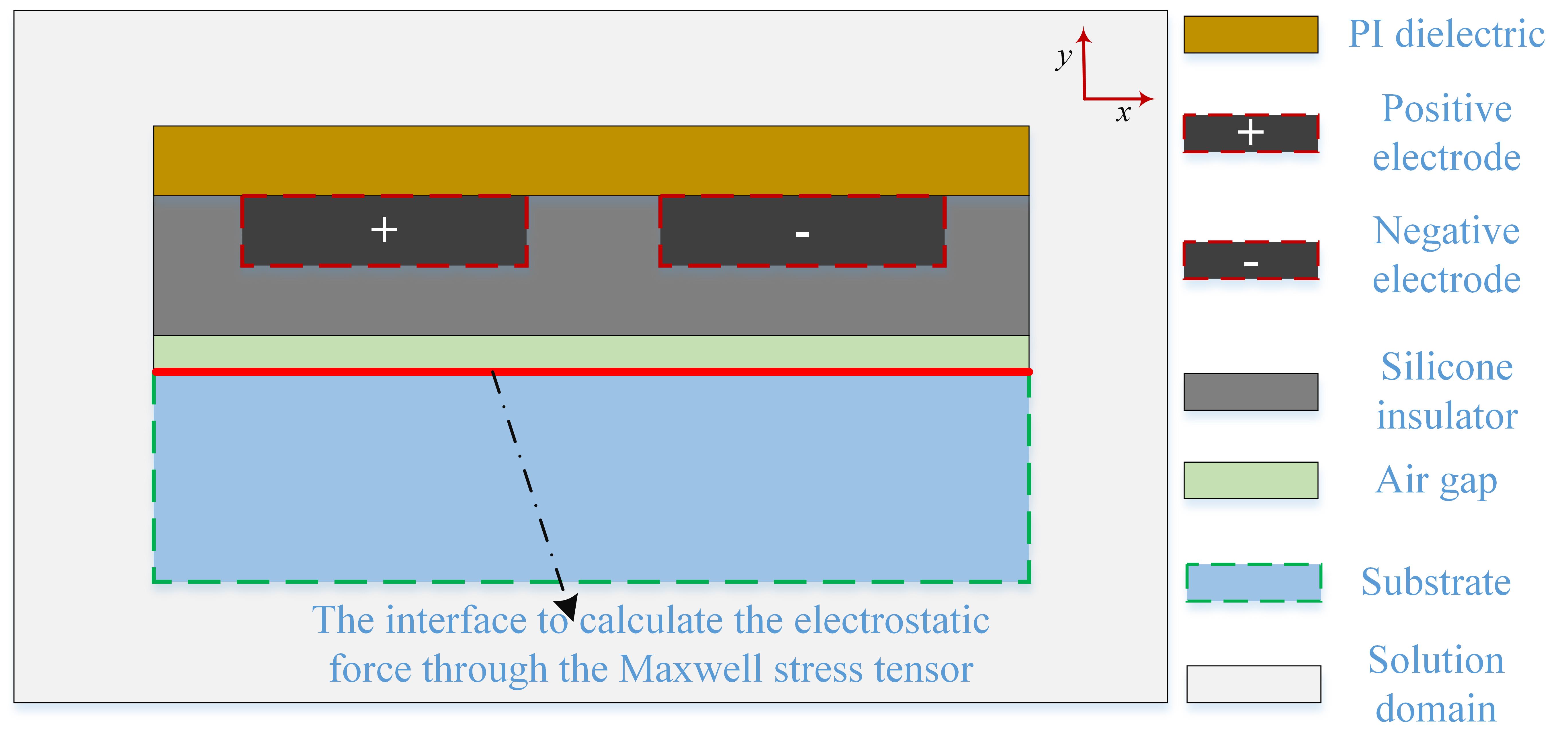

Dear Mr. Olsson, First of all, thank you very much for your good advice. But I still feel uncertain. I want to simulate the electrostatic attraction force through the AC/DC module of COMSOL. The schematic diagram of my 2D model is shown in the attachment (figure.jpg). When the high potential difference is applied between metal electrodes (positive electrode is applied high potential, negative electrode is applied low potential or grounding), the fringe electric field generated by the metal electrodes will produce electrostatic attraction force on the insulating substrate (due to polarization) or conductive substrate (due to electrostatic induction). 1. In the post-processing, I obtain the electrostatic attraction force per unit length by integrating the Y component of Maxwell's surface stress tensor on the upper surface of the substrate (as shown in the red solid line in figure.jpg). However, because the surface is the boundary of two different materials (that is, there are different dielectrics on both sides of the boundary), its normal electric field intensity will be discontinuous, resulting in the discontinuity of the Y component of the corresponding Maxwell’s surface stress tensor. At this point, I'm not sure which Y component of Maxwell's surface tensor (es.unTy, es.dnTy, es.unTey, es.dnTey, es.nTy) in COMSOL is used for integration. And as you said, the local surface force density (Y component of Maxwell's surface stress tensor) on a dielectric boundary should be the sum of the up and down Maxwell stress tensor variables (such as es.unTy+es.dnTy, or es.unTey+es.dnTey). However, I see that some references seek the difference of the up and down Maxwell stress tensor variables rather than the sum of the up and down Maxwell stress tensor variables (such as formula 8-10 in the attachment(1.pdf) and formula 9 in the attachment(1.pdf)). And the local surface force density (Y component of Maxwell's surface stress tensor, such as es.unTy and es.dnTy) on a dielectric boundary obtained by me will be different in symbols due to the difference of substrate materials. For example, when the boundary is the boundary between air and upper surface of substrate and the substrate is insulator (glass), the es.unTy and the es.dnTy are positive, and the es.dnTy is equal to the es.nTy. But when the substrate is conductor (Aluminum), the es.unTy is negative, and the es.dnTy is positive, as well as the es.dnTy is equal to the es.nTy. Furthermore, when the boundary is the boundary between the lower surface of silicone insulator and the upper surface of substrate (that is, there is no air gap between silicon insulator and substrate) and the substrate is conductor (Aluminum), the es.unTy is positive, and the es.dnTy is negative, as well as the es.dnTy is still equal to the es.nTy. I know the “up” and “down” means the surface normal directions through the variable definitions in the help files. But how do I understand the symbolic differences of es.unTy, es.dnTy in different substrate material? 2. When the substrate is conductor (Aluminum) in my model, I don’t find that one of es.unTy or es.dnTy would valish. I agree with you, but I can't explain that both es.unTy and es.dnTy exist. Should I add special boundary conditions to the aluminum substrate, such as grounding it? 3. I know that I can do the same calculation by volume force, which is essentially integrating the Y component of Maxwell's surface tensor in the all outer surface of the medium. However, for two-dimensional simulation, I need to integrate the Y component of Maxwell's surface tensor in the upper surface of the substrate separately. That's why the problems I encountered above appeared.

The source of the difficulties here is that you are trying to model what I would call an electrostatic contact problem. That is when you have a dielectric with embedded sources being attracted to a metallic surface and making contact - similar to a fridge or whiteboard magnet attaching to a ferromagnetic plate. The key to success is to realize that there is a small or virtual air gap between the pieces. That is, when pulling apart, an air gap wll form rather than a gap of metal or dielectric. You have two choices to do this illustrated by the two attached models. One is intrducing a small gap in the geometry that is meshed using a a mapped mesh to avoid an excessive number of elements. The other model uses a virtual air gap using the Thin Low Permittivity gap feature. In both cases, the metal needs to be grounded. And, as the Thin Low Permittivity gap feature is only allowed on interior boundaries, a domain constraint has to be applied for the grounded electrode. Note that the attaching force is obtained as a limiting value as you make the air gap thinner and thinner, hence the parametric studies.
When it comes to using the up or down Maxwell stress tensors and difference or sum. One should use a sum or, on an outer boundary, the down variant (as then the up variant does not exist). The two variants are computed using antparallel surface normals so the "minus sign" is inherently accounted for - hence using the sum. Note that when making an internal boundary external by disabling an adjacent domain, the definitions of "up" and "down" may switch - you can see that when comparing expressions used in the Line Integration features in the Results section for the two models - one has an internal ground bundary whereas the other one has an external ground boundary and I chose to integrate the force on the electrode rather than on the dielectric-air interface.
In the models, I assumed that there is a larger array of electrodes so I used periodic conditions for a symmetric unit cell. Actually a smaller antisymmetric unit cell could have been used.

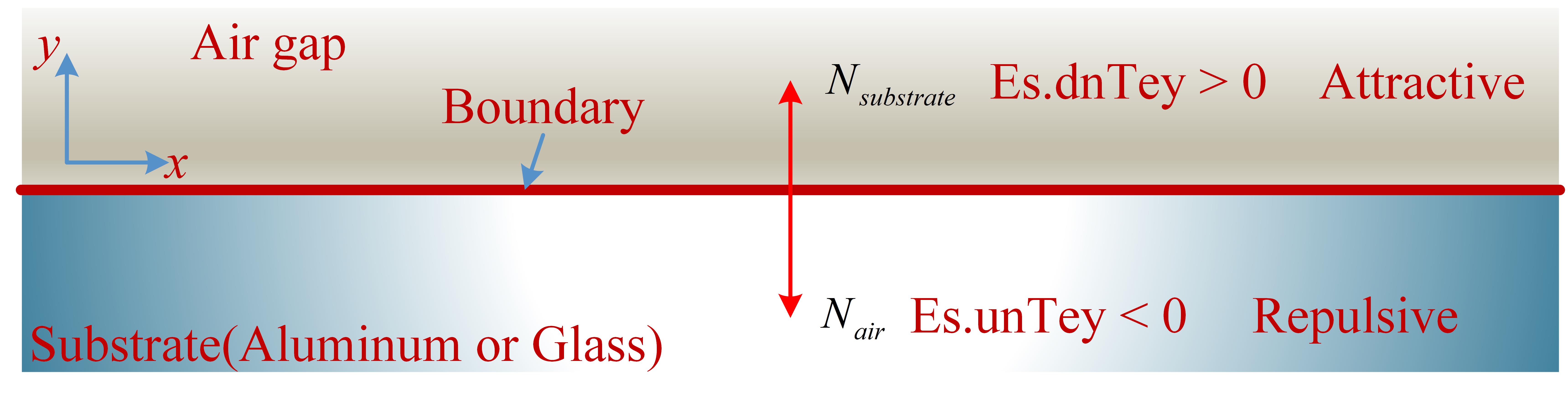

Dear Mr. Olsson, Thank you very much for your further explanation! With your help, I can basically understand all the questions I consulted you above. But as for the signs of es.unTey and es.dnTey, I'd like to consult you in combination with the schematic diagram (as shown in figure.jpg in the attachment). Because I don't quite understand what you mean by "other piece" at last. I'm afraid I misunderstood it. In the figure.jpg, the Cartesian coordinates are represented by x and y, respectively. The boundary between the air gap and the substrate is described by the thick red solid line. The Nsubstrate represents the normal vector of the substrate at the boundary. And the Nair represents the normal vector of the air gap at the boundary. The results of the solution is es.unTey < 0, es.dnTey >0 (As you get from your model). Now, my understanding is that: es.dnTey >0, and its normal vector direction coincides with the positive direction of Cartesian coordinates y, so the “+” sign of es.dnTey means “attractive”; similarly, es.unTey < 0, and its normal vector direction is opposite with the positive direction of Cartesian coordinates y, so the “-” sign of es.unTey means “repulsive”. Is that what you mean? Thank you again for your patient explanation. I look forward to your further reply. Thanks!
The surface Maxwell force density is defined as (es.dnTex+es.unTex , es.dnTey+es.unTey). In the attached version of the model, this is plotted on the surfaces of the substrate (white arrows) and the chuck (black arrows). Now, when looking at the sign of the Y component, it is clear that interpreting that as "attraction" or "repulsion" depends on what piece (substrate or chuck) you are evaluating at. Further it depends on the relative positions of the chuck and substrate - rotate the geometry by 180 degrees and the signs/vector directions are reversed, rotate by 90 degrees and you have to look at the X component, etc. etc. That is what I mean by "your bookkeeping" and why I am reluctant to state something like "positive sign means attraction" as it depends on how the model is defined/oriented and on what side of the air gap you are evaluating.

Dear Mr. Olsson, Thank you very much for your patient explanation and help. Based on your explanation, I fully understand the problem now. Thanks!

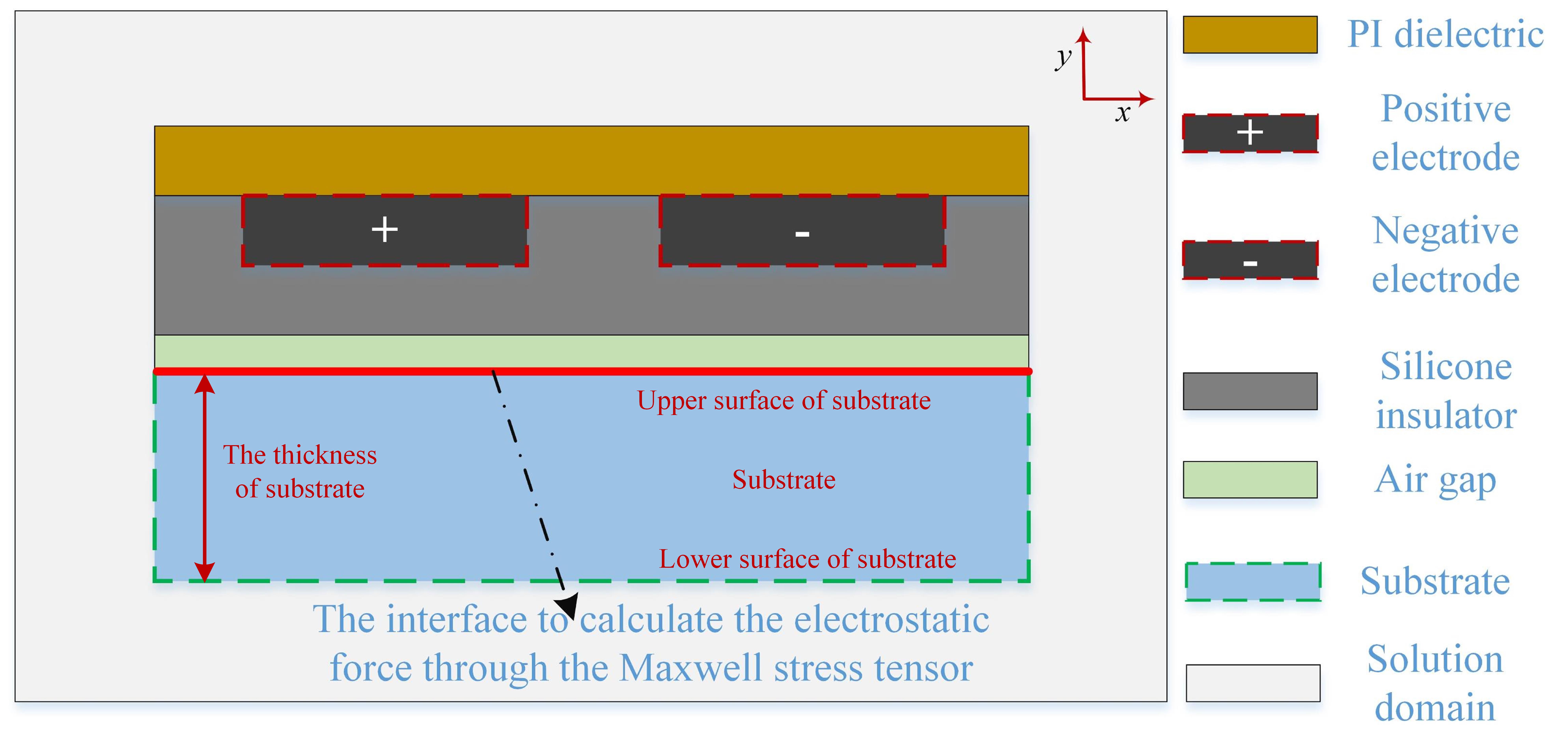

Dear Mr. Olsson, I'm sorry to bother you again. Continuing with the previous question, I would like to consult you again about how to realize "zero potential at infinity" in COMSOL. In my previous model, the substrate has finite thickness, and I directly grounded the lower boundary of the substrate. Now, I want to simulate a more realistic situation, that is, the substrate has infinite thickness (in the - Y direction) compared with the electrostatic chuck. In this case, how can I add boundary conditions to the substrate? I have tried to use the substrate as an infinite element domain directly, or add an additional area under the substrate and set it as the infinite element domain, and then ground the bottom boundary of the infinite element domain. I think that after this, the change of substrate thickness will no longer affect the electrostatic attractive force on the upper surface of the substrate, but the actual result is that the electrostatic attractive force is still dependent on the thickness of substrate. If it is assumed that the substrate has infinite thickness and the potential at infinity is zero, will the actual thickness of substrate in the model affect the electrostatic attractive force on the upper surface of the substrate? At this point, I would like to consult you again: in the examples you gave me, you grounded the upper surface of the substrate. But in practice, the grounding of the lower surface of the substrate is more consistent with the actual situation. Why didn't you ground the lower surface of the substrate? However, I found that only when the top of the substrate is grounded, the electrostatic attractive force is not dependent on the thickness of substrate. I look forward to your reply. Thanks!
I guess your model is in planar 2D, right? Then, the assumption of zero potential at infinity is not correct. It is inherent in the assumption in planar 2D that we are modeling an object that is of infinite extent in the out-plane direction. For example two concentric circular electrodes with air in between (infinitely long cylindrical capacitor) with the inner electrode holding a fixed charge, one can easlily show that the electric field must scale as 1/radius. However, if you try to intergrate that electric field to infinite radius (to get the capacitor voltage), that integral diverges (as log(radius)). Thus, in 2D, the best you can do is to assume gound at finite distance.
Note also that the problem arises only when you are considering a 2D monopole field. If you have two or more poles (electrodes) separated by a finite distance and held at different potentials (or with balancing charges, i.e. no monopole component), you will have a potential that approaches a constant value at infinity. This is because dipole fields (and higher multipole fields) fall off more rapidly with distance.
I should also add that in my model, a metallic substrate was assumed and that is by definition an equpotential domain in electrostatics (no currents and, hence, no resistive voltage drop). Thus, if it is grounded at any end, all of it will be ground.

Dear Mr. Olsson, * Yes, I did do a two-dimensional simulation. * Maybe you misunderstood me. As shown in the figure.jpg in the attachment, my means is that the substrate has a great thickness relative to the electrostatic chuck in the two-dimensional plane, that is the lower surface of the substrate is infinite in the negative direction of y (-y). How to set in COMSOL so that the substrate has infinite thickness and the potential of its lower surface at infinity is zero? * In my model, I apply a positive voltage of 2500V to the positive electrode and a negative voltage of -2500V to the negative electrode. When the substrate is the metallic (such as aluminum), I need to set the dielectric constant in the metal material properties as large as possible (such as 50000) in order to make the grounding results of the upper or lower surface of the metal substrate consistent. That's what you said--“I should also add that in my model, a metallic substrate was assumed and that is by definition an equpotential domain in electrostatics (no currents and, hence, no resistive voltage drop). Thus, if it is grounded at any end, all of it will be ground.” * However, if I follow the default metal material properties of the software (dielectric constant is 1), the results of the upper surface grounding of the metal substrate and its lower surface grounding is different. However, if I apply the floating potential to the upper surface of the metal substrate and ground the lower surface, the result of which is consistent with that of only grounding the upper surface of substrate. And it is also consistent with the result that the dielectric constant of metal is 50000. * Now I don't quite understand how to set the boundary conditions if the metal substrate is the insulator (such as glass) ? I have grounded the upper or lower surface of the insulating substrate, and the results are different. And only when the upper surface of the insulating substrate is grounded, the result is not affected by the thickness of substrate. * I look forward to your reply. Thanks!
First of all, I would like to repeat that the Electrostatics formulation/interface is not intended for the simulation of the interior of metallic domains! Only dielectric properties are properly treated. Applying a metallic material to a domain will not result in that domain becoming an isopotential domain. It is up to you to exclude metallic domains from the Electrostatics selection and apply suitable boundary conditions on the boundaries of the excluded domains.
In your case, grounding the upper surface of the substrate (and excluding its domain) only makes sense if the substrate is metallic. If the substrate is a non-conducting dielectric, you should include its domain and apply either Ground or Zero Charge to its lower surface. If it has a high permittivity and is thick enough, the forces should not depend much on which of those you choose, see attached model and try enabling/disabling the Ground feature. There is not much of a difference in the force values.
I would say that in planar 2D, one should never apply Ground on the outside of an infinite elements domain for the reasons I explained before (monopole potential diverging as you go to infinity).
