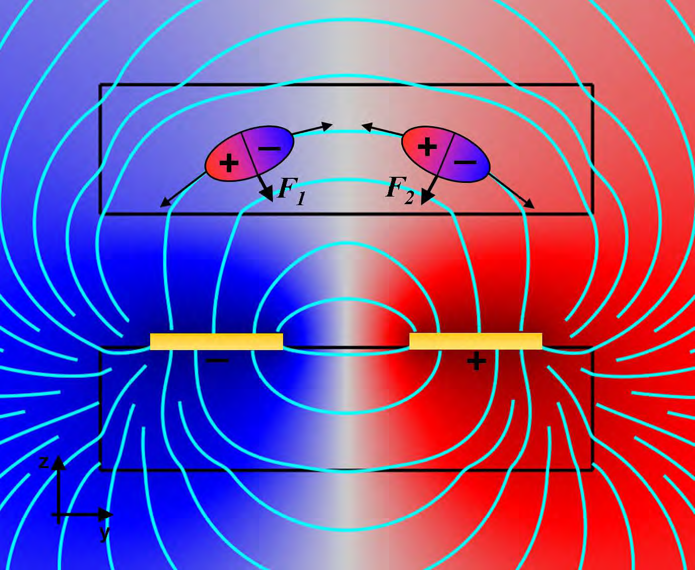

Thanks Ivar.
With reference to attach file, consider a dielectric mass with two electrodes fixed to its surface. This construction is held at some small distance from a second dielectric mass which we wish to control. Imagine two molecules in the target dielectric placed symmetrically about the mid plane of the diagram. Creating a potential difference across the electrodes gives rise to a fringing field which polarises these molecules. Since the electric field is non-uniform the forces acting on the the positive and negative charges are not quite collinear leading to a resultant force on each molecule F1, F2. By symmetry the total force on the pair of molecules F1 + F2 is downward (negative z direction).
The problem is that I do not get the mass movement. i'm checking the boundary conditions, but no obtain movement.
Thanks Ivar. With reference to attach file, consider a dielectric mass with two electrodes fixed to its surface. This construction is held at some small distance from a second dielectric mass which we wish to control. Imagine two molecules in the target dielectric placed symmetrically about the mid plane of the diagram. Creating a potential difference across the electrodes gives rise to a fringing field which polarises these molecules. Since the electric field is non-uniform the forces acting on the the positive and negative charges are not quite collinear leading to a resultant force on each molecule F1, F2. By symmetry the total force on the pair of molecules F1 + F2 is downward (negative z direction). The problem is that I do not get the mass movement. i'm checking the boundary conditions, but no obtain movement.
