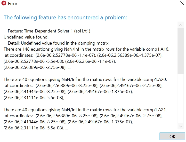

I followed your advice and have changed my simulation to be worked in the time domain (temw). I followed the steps in the Example "Transient Modeling of a Coaxial Cable" in the Application Library. However, I have got the attached error message.
Would you please tell me how I can solve this problem?
I think the problem is that in the Zref text field, I typed the below equation: (Z0_const/2/pi)*log(width of the core).
Best regards, Manal

Based on your previous posts, my guess is that you are trying to simulate heating of the absorber in response to a train of Gaussian pulses.
If so, you want a transient simulation but of a particular type. If you simulate the Gaussian pulse itself, you need several time steps per (optical) cycle, requiring an absurd computation time.
I think you will get the results you want if you use the preset study Frequency-Transient. That study becomes available if you select both emw and ht physics and then select Electromagnetic Heating physics. This physics solves the EM equations at the frequency specified and applies the time-averaged EM heating for the heat transfer problem.
In emw you will be able to write for the port power, say, 1[W]*f(t) where f(t) is the envelope for your Gaussian pulses.
Be aware that these multiphysics problems may not converge well and may require non-default settings for the solvers for reasonable computation times.
You may want to set up a Frequency-Stationary study first as this calculation is faster and easier to troubleshoot.
