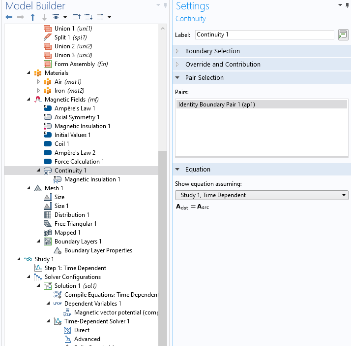

I'm using COMSOL Multiphysics 5.4.0.388.
I'm follwoing through every step of the online COMSOL tutorial: "Modeling a Solenoid Actuator" - Part 13 of COMSOL's modelling a coil series.
In the video (around 30m:09s), the COMSOL representative adds a continuity in the magnetic field section. Then, he opens up the constraint settings, and manually enables 'Use Weak Constraints'.

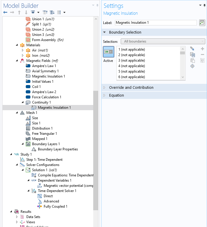

Unfortunately, I do not even have a constraint settings tab on my version of COMSOL. I have attached screenshots of my COMSOL model - the options for constraint settings do not appear in the 'continuity' branch of my model, nor it's sub-branch 'magnetic insulation 1'. There should be constraint settings in both of these branches.
Does anyone know the cause of this? Is this perhaps a feature of an older version of COMSOl, that has now been removed? If not, do you know what else it could be?
