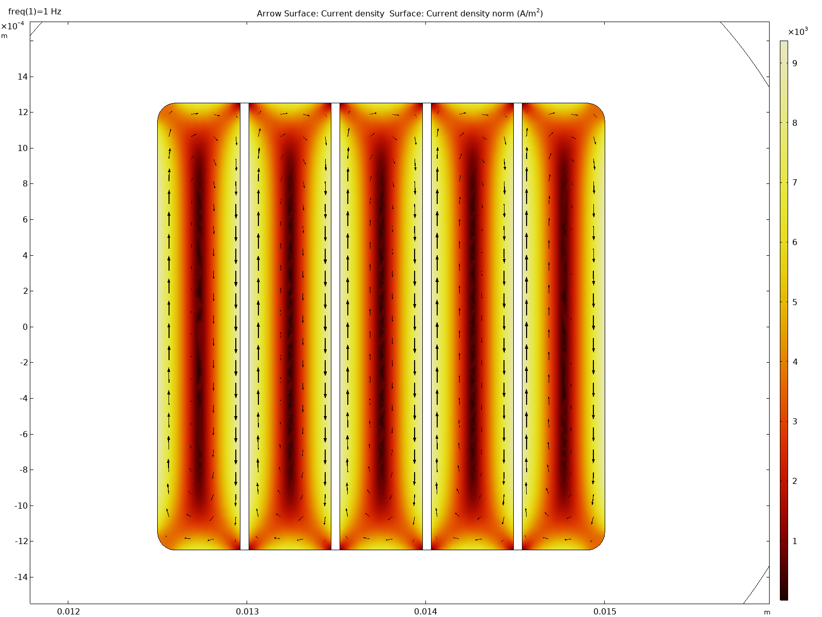

You are absolutely correct, the magnetic flux is only in the phi or azimuth direction. The eddy currents on the other hand are in-plane, which is what I am mainly interested in. The goal is to introduce structures in order to reduce the eddy current losses. I did manage to create a model which does show the expected behaviour (see attached figure) but this requires using domains instead of edges, leading to a large number of degrees of freedom.
Best regards Carsten
