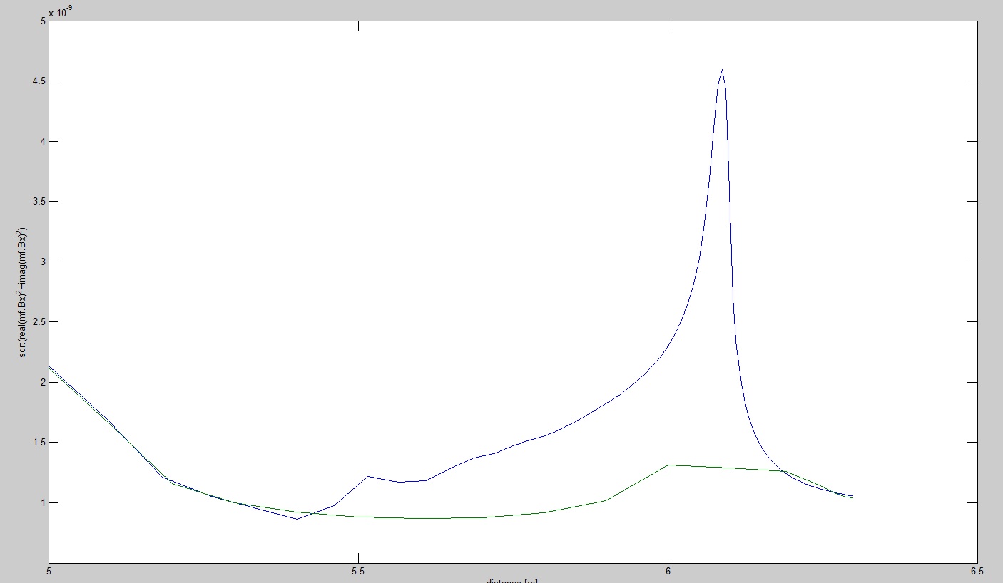

EDIT : I do that. I upload an image plotted with matlab, comparison of defect-no defect, for Module(Bx) in function of x.
I don't understand why module increase at 5.5 meter in defect simulation.

the EM field will concentrate on the edges and the vertex, as you have sharp edges, you get strong fields locally and shielding effects that make the observation of your air slot, less than "evident".
You could test it out on a simple Al (foilleted) rectangle with a round hole in the middle, which is simpler than your L bracket beam profile
You do not need to go to matlab to plot line curves, you can do that either on your edges (boundaries) or on Data Set Cut lines you might define
